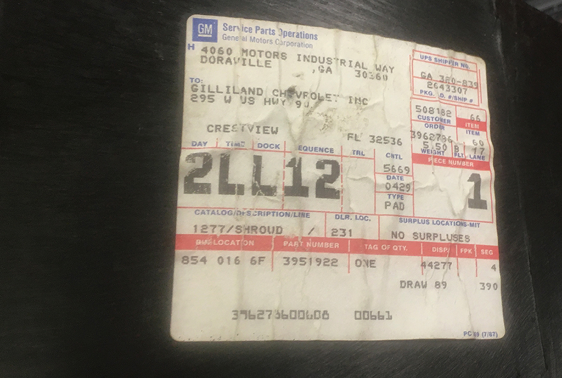

Here is the NOS one I put on my truck (showing sticker) - I can take a picture of the installed shroud (fan side) and check the distance on my '72 4x4.
646870SS is offline   Reply With Quote

Thanks for the picture of the label 646870SS, with the part number I did a little more research and that would be the correct shroud for my 67. I was able to verify it on GMPartsWiki here: http://www.gmpartswiki.com/getpage?pageid=21326 (starts at bottom of page).
