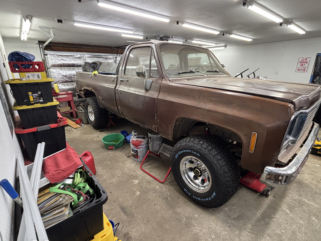

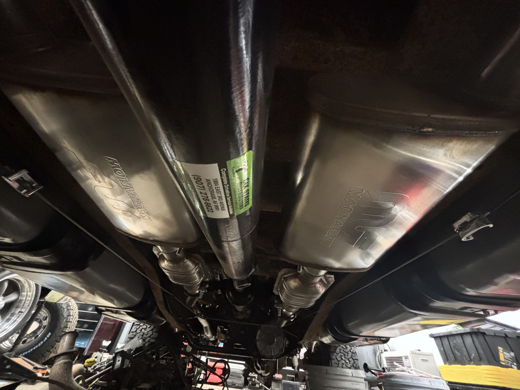

Alright, here’s the major update!
Finished under hood product!
Cleaned out in and around the truck!
Brought it outside and wiped everything down!
Loaded on the trailer to take it in for alignment!
Back home from alignment!

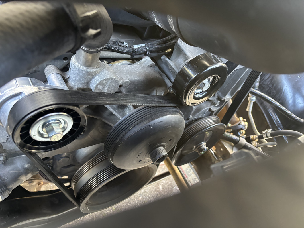

The truck needed a few final touches. The original starter was hanging up, and the tensioner/pulleys were squeaking, so I bought a new OEM starter and picked up a tensioner/idler/belt kit.
