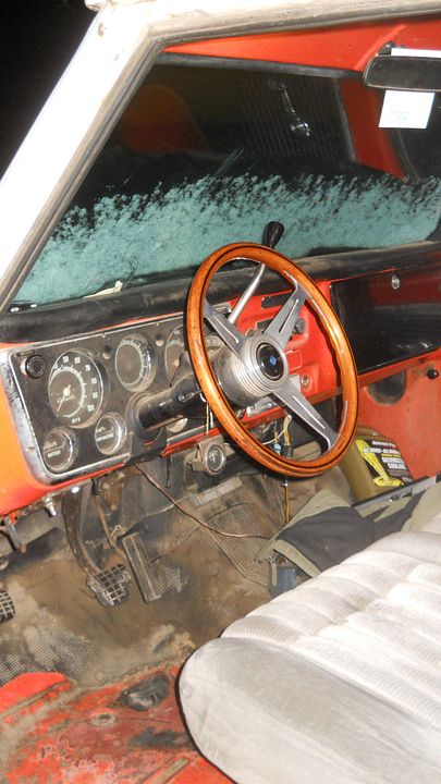

This is one of those things that I have been thinking about ever since I put the Nardi wheel in my 71 GMC 2500.
Old photo just after I put the wheel in.
