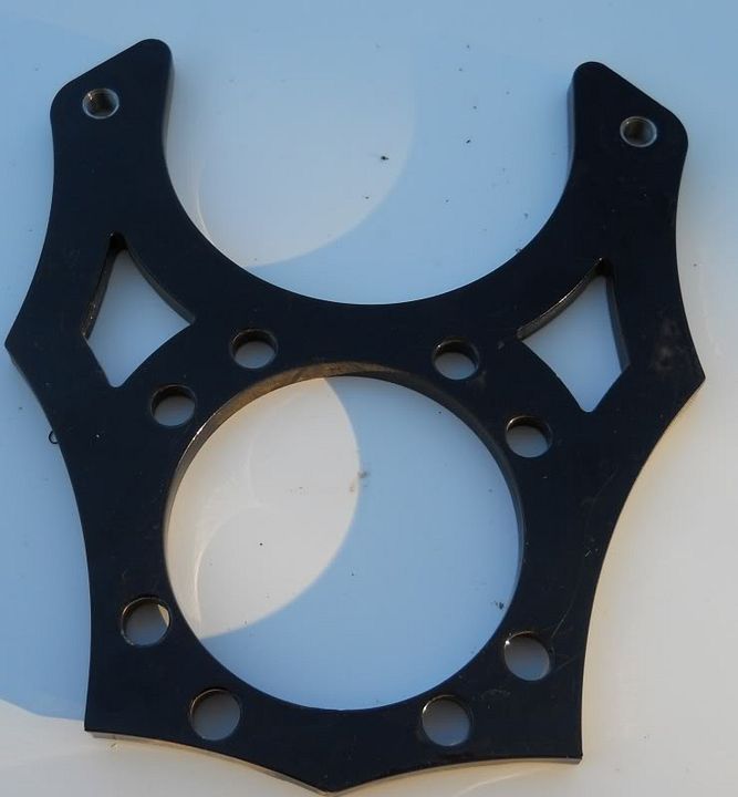

It's not a bad or hard project to redo the drum brakes if your drums are good and can be turned.
Rock Auto shows a 12 inch RAYBESTOS 2071R as the rear drum. Shoes, wheel cylinders and axles seals are pretty easy to find.
I bought the disk brake brackets and rotors for my 71 but haven't done anything about installing them. Checking lugnutz I'm thinking about ordering their calipers.
These are the brackets I have but now I am wondering if they are correct.
I wanted disk on the rear becaused I tow my 25 ft Bayliner with the 71.
Looks like the lug nut kit bracket
