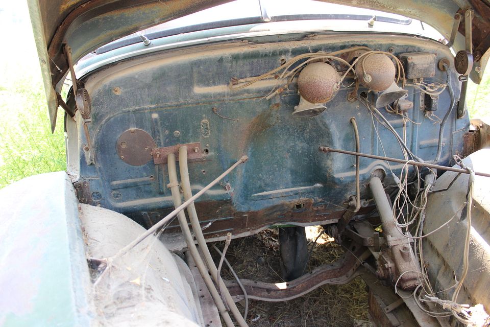

Does anyone have a pic of the heater hose connections on a 51 GMC half ton? Would be greatly appreciated.

which heater? Commonly in BC I see the 'standard' or 'deluxe' being what they came from factory with. Both were options and BC trucks usually had one or the other. If your cab came from elsewhere it could have had nothing or any one of many aftermarket heaters.
The standard heater was round, mounted direct to firewall and the copper pipes protruded through the firewall. From engine side there was a large round blanking plate

The deluxe was larger, connected to the passenger side kick panel to get fresh air from exterior louvers. The heater was spaced off the firewall on inside, the copper pipe on heater core connected with short sections of heater hose to a valve that protruded through firewall. The end of the fan motor protruded through firewall where the standard heater had a blanking plate

deluxe from engine side

Here are the firewalls on two 51 cabs I have (out of 3) I marked where the hoses and control valve go for both std and deluxe heaters on one and the other still has the standard heater in it.

Thanks guys for the pics. My truck came from Yakima, Washington and I see from the pics that it has the deluxe heater. Leegreen the pic you sent from the engine side was exactly what I was looking for. If I had to guess, that was what I was going to do for the connections.And the info on the heater core maybe not standing up to the higher pressure is good to know and know where to get one that will.
