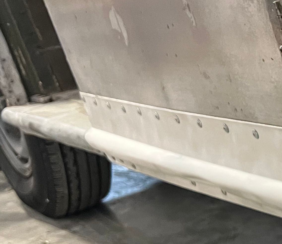

Next on the Metro's list, as can be seen in the above pictures, is the patches for the wheel arches. We started with a paper pattern to capture the bead details and transferred that to the sheet metal using the trusty ice pick.
Once cut out, the lower flange was hammered over by hand and then stretched using the linear stretch dies in the Lennox.
Then run through the shaping dies, the folded flange acts as the guide for the dies.

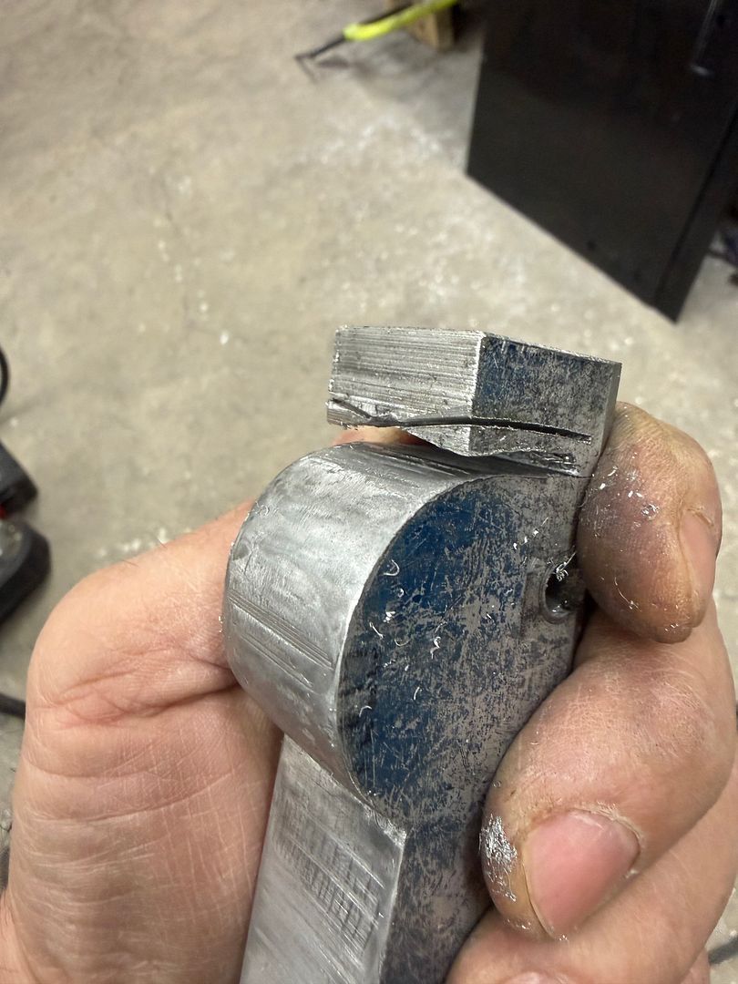

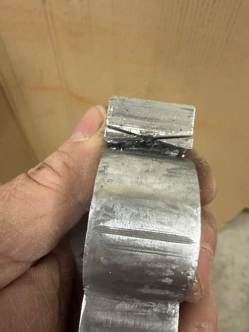

The radius at the bottom of either end of the wheel arches was a bit too tight for the dies in their standard form, I had to add a relief and neglected to get pictures..
To make room, the die was modified using a portaband to cut an X pattern, then a small screwdriver to bend the center tang back and forth until it broke free.

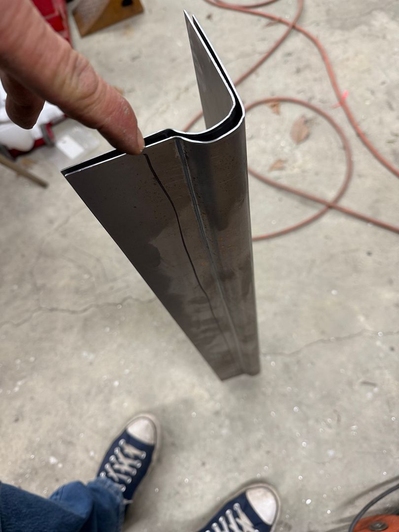

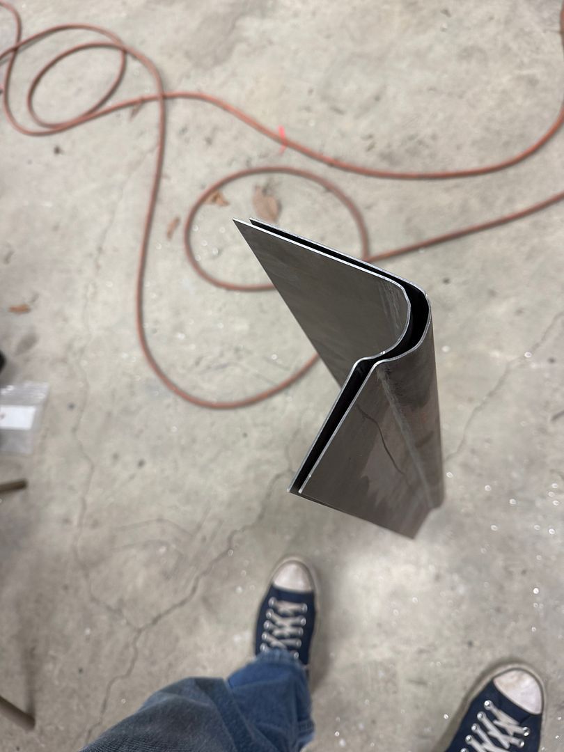

After the wheel arches, we had one more area to fabricate, the step going into the side doors.
Time to modify the bottom die again...
Then we started with an 8" wide piece with a 90 folded down the middle, using a .25R die. The fold was held in snug against the back of the die to act as our guide. Cut off piece was saved in case we need to weld it back on for another set of wheel arches..
These will be trimmed on the bottom to match the adjacent patches, somewhere along the sharpie mark.
