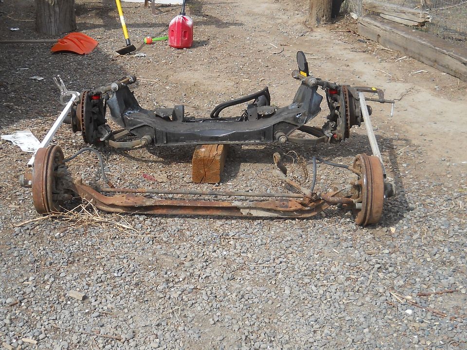

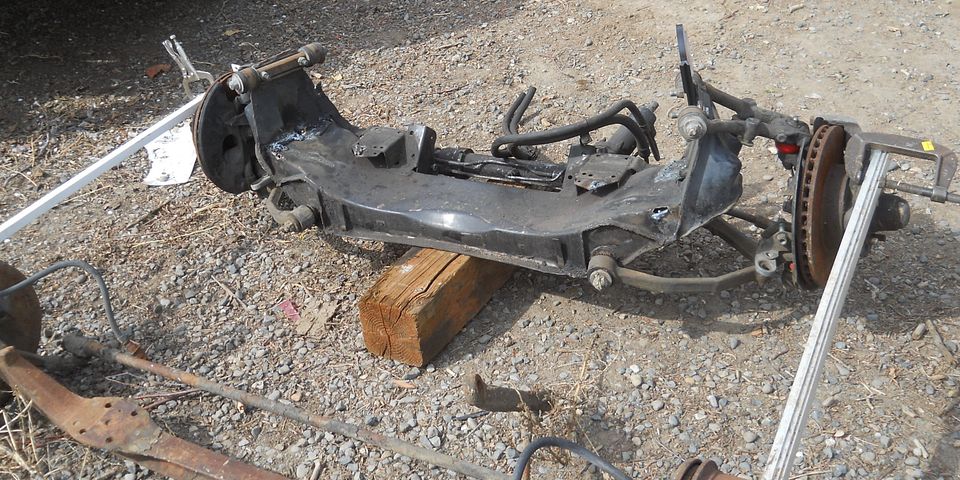

The whole assembly unbolts from the Jag with just a few bolts but has a lot of brackets that have to be cut off. This is the one that belongs to a member on here.

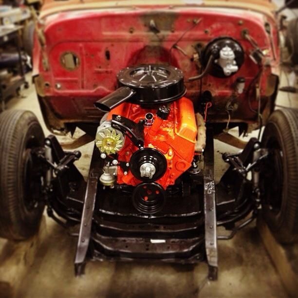

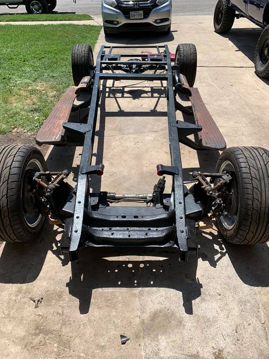

This is one I found on the net. It may or may not belong to a member.
Another net find with a GMC frame.
The one I have that I bought in Bend Oregon a few years ago compared to a chevy truck front axle.

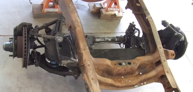

A closer idea of mine giving you and idea of where you might notch it.
