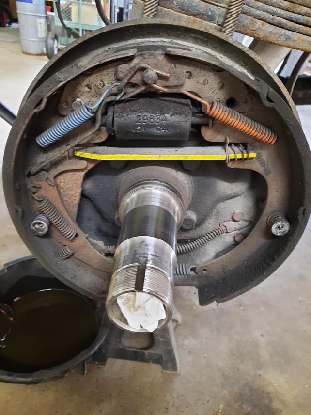

I'm doing a brake job on my C20 ('76 GM 14 bolt rear). I took pics before disassembly but can't find then.
Anyone have pics of the assembly - mostly the spring placement.

Heres a picture from my '74 K20, this is the passenger side so the orange spring is forward, blue spring toward the rear. Hope this helps.
Perfect.
Thanks!
