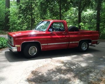

Did about a dozen C10s that way back in the day.
My red truck was a daily for 30 years and 200,000 miles. Cut coils in front, relocated spring hangers in rear.
