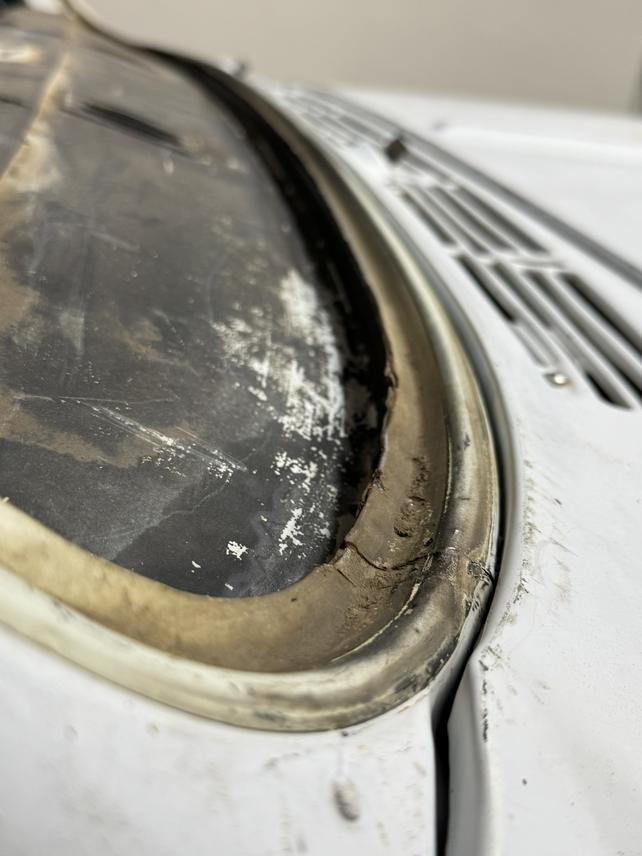

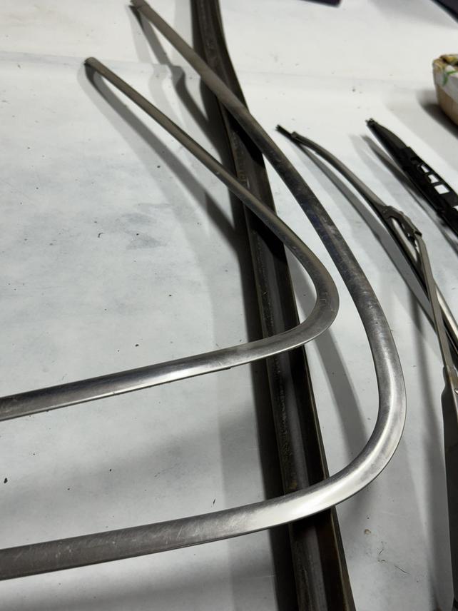

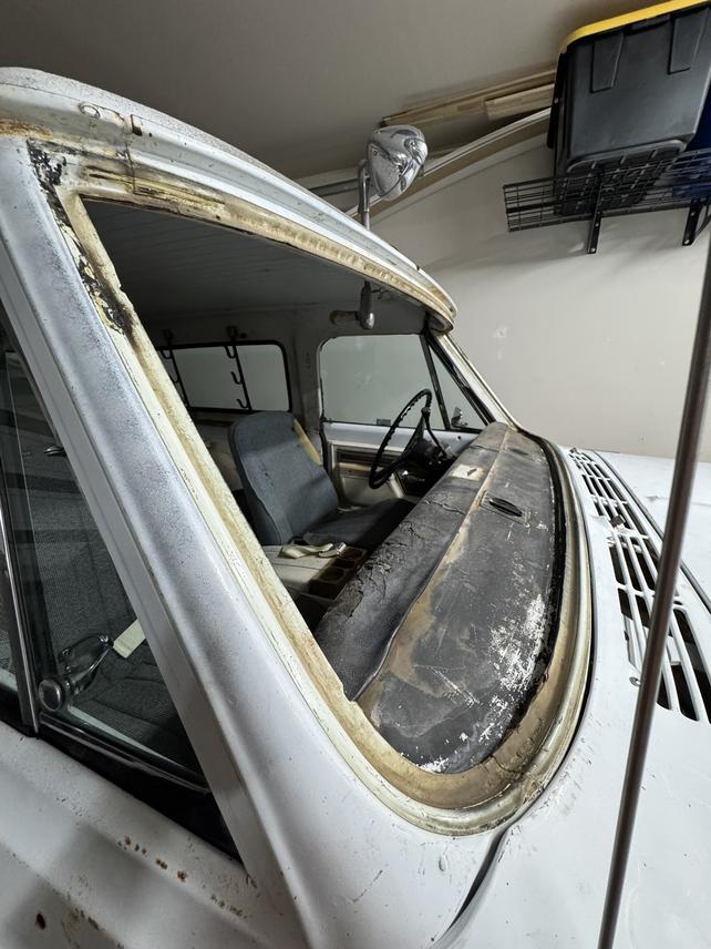

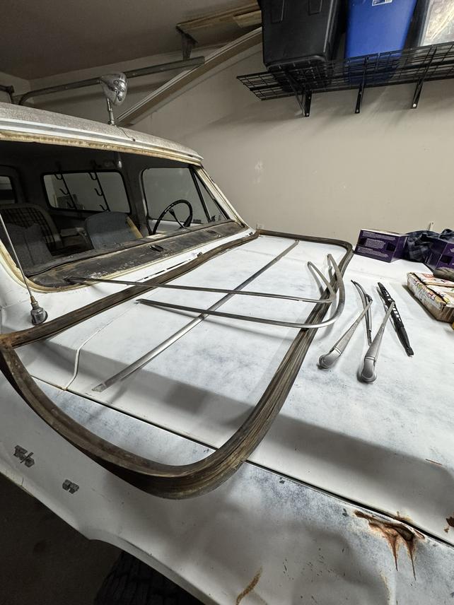

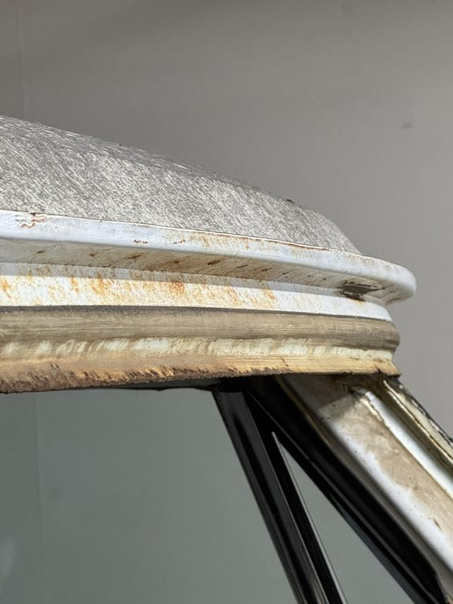

Another pint sized update. I was able to carefully remove the CST windshield trim and then break out the old windshield without damaging the original weatherstripping. Taking advice from user notsolo above, I also purchased some wintergreen oil and will be restoring the weatherstripping.
Because a full repaint isn't in the cards near term, I plan to order an aftermarket molding and install the replacement glass for interim driving, and then reusing the CST stainless bright work and OEM molding come proper restoration time.
The rust isn't bad on the frame. The upper section where I see most rot on other chassis has some corrosio along the lip. I'll be grinding it out and then decide on how to repair before reinstalling glass. Not sure if its bad enough for a patch panel at this time until I grind with a flap wheel.

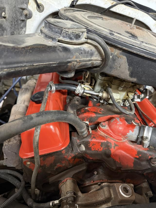

Howdy everyone, not much progress here but we are making some.
The new windshield is in and it is much nicer to drive without staring through all the bubbles/cracks.
I had a really bad oil leak coming down around the #7 spark plug area on the drivers side rear of the block. It would drip off the oil filter a puddle about the size of a small plate every drive. I figured it was the valve covers which were aftermarket "ERSON" branded chrome units. I am working towards more of a close to original restoration so I bought off eBay some cleaner used SBC valve covers, stripped and sanded them down, and then refinished in the proper orange.
While installing the new valve covers with Felpro gaskets I found the leak culprit. When installing the ERSON units, which I'm unsure how long this had been going on, the ground strap on the rear lower bolt hole was under the cover instead of over. With this fixed up the leak is gone and one less mechanical issue.
For the spring my major focus will be on continued fixing of mechanical issues.
My biggest ones right now:
-Brakes seem to occasionally lose pedal pressure (pedal falls to floor). Could be master cylinder but I'm going to replace the wheel cylinders, calipers, rotors, pads and shoes, along with rubber sections. It's just old and tired and needs a full redo.
-the TH350 doesn't shift up always. If I pop it down to L1, then move to L2 then L3, it always shifts when I tell it to, but if I leave it in drive sometimes (most of the time) it doesn't shift out of L1 from a stop. Any thoughts on where to start with this? Linkage I assume down on the transmission needs some tweaking but I'm just not super familiar with Autos.
-Idle is a bit "cold blooded". Usually needs help with small applications of the throttle for first 30-60 seconds. Once warm it does great.

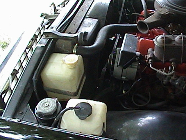

Here is a pic of correct radiator fluid overflow tank. It is the one mounted on the core support.
Some use a windshield washer tank. You can use a later model style that looks more OEM.
