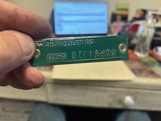

OK now I'm more confused. Mine isn't even on that chart
C254 6Z112492. What am I missing?

The chart is for a '64 since they didn't show a '66 truck chart.
Fremont is Z for 65/66 passenger cars so I'd say Fremont build.

Definitely a Fremont Ca built truck . I'm working on one now and there's a lot of fawn showing on the front of the door jamb. Hinges are covered though.
