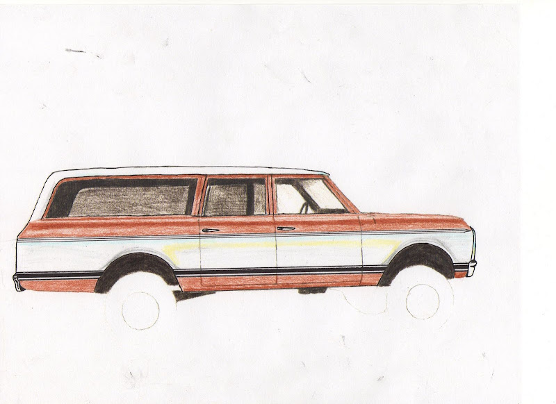

I didn't really get anything done on the Suburban today other than pulling parts off so I can do rust repair, but I did get an itch to do some concept sketches. I am leaning towards #3 or #4, not sure yet. Input?
#1
#2
#3
#4

I vote #4

I vote #2. Cool project. I'll be following along.

I appreciate the input on the paint schemes! Thanks!

I like your 3 and 4 concept, but wowzers, all that trim will be expennnnnnsive!

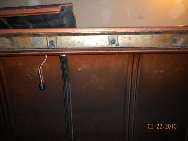

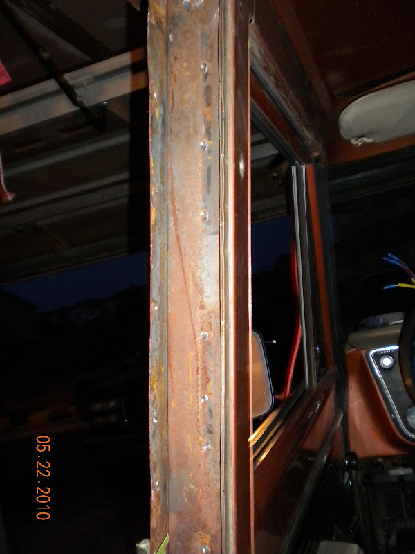

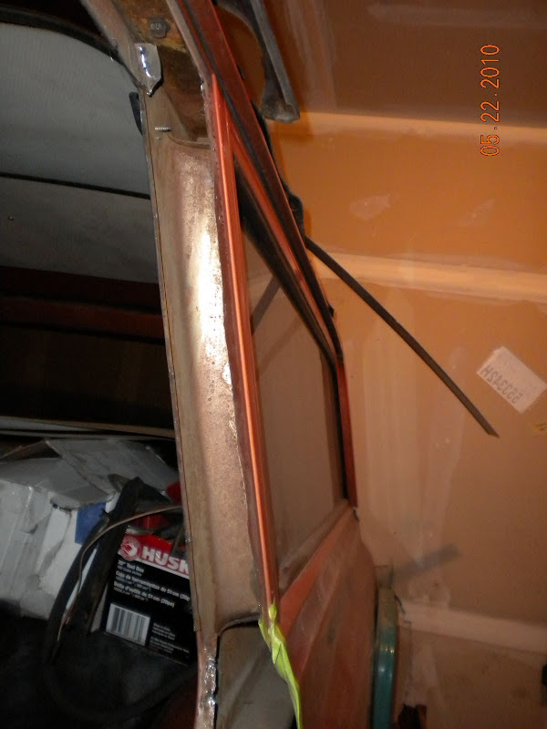

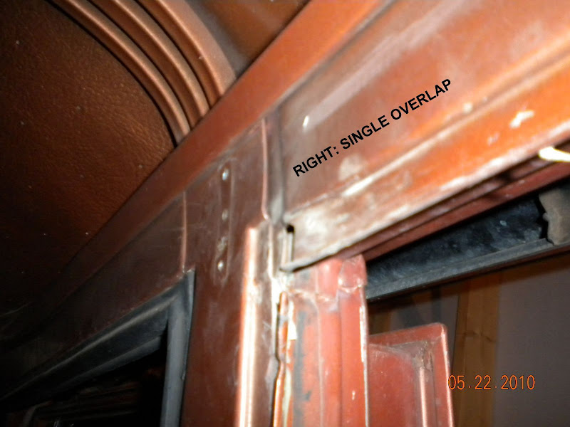

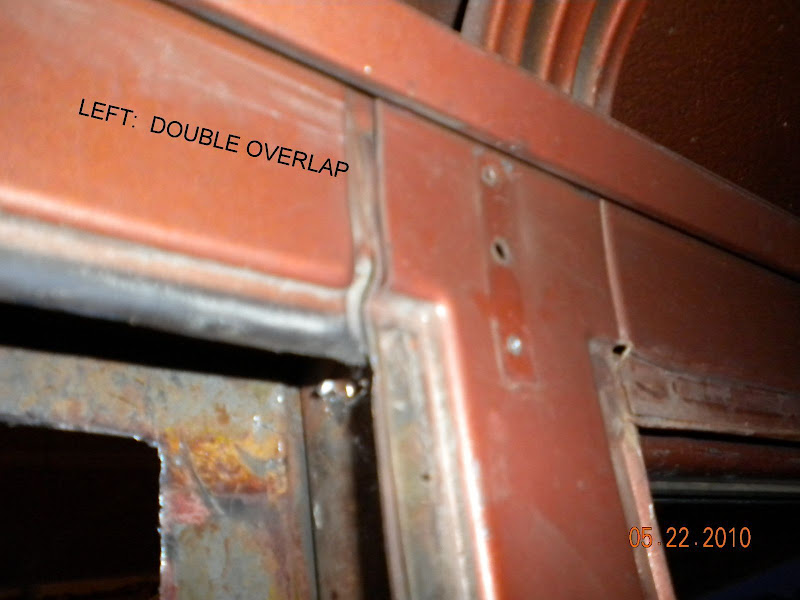

Update: got some time between work and drills to spend some time on the Burb. It's the point of no return!
For those who want pictures, here they are
This will be the only difference between right and left B-posts. I may weld these seams later anyway.

I like #3, especially since that's how I painted mine, . Good news for you, Mar-K out of Oklahoma city now makes the correct length upper trim for the suburban (I should have pictures in a week or so). Also, Rokcrwln has a good write up on making the 4th door here: http://www.67-72chevytrucks.com/vboa...=188993&page=3.

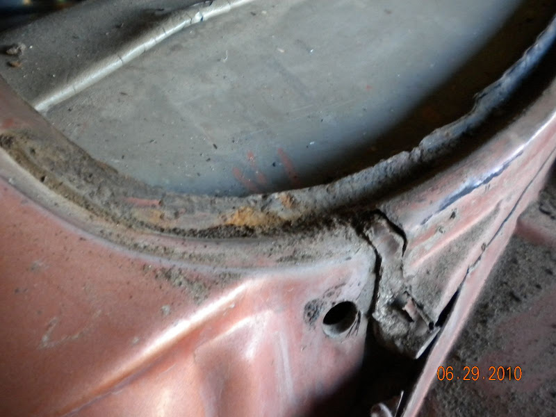

BAD DAY!!!!!!!
I am pulling all the glass so I can do rust repair and don't do any dammage with the grinder or welder... This is the first windshield I split durring removal. On the plus side, once it was cracked, the size 13 sandal made removal a snap! I still upset about making a stupid mistake (check inside trim for silicone!!!!)
I did have water in my windshield trim...
my rust issues aren't very bad in the windshield frame... that's a plus!
There was some sealer, just not enough.

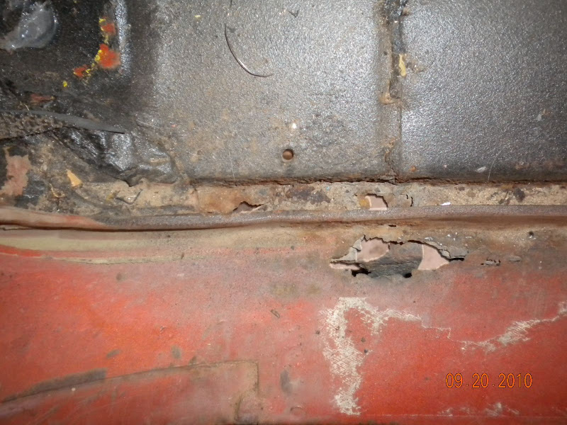

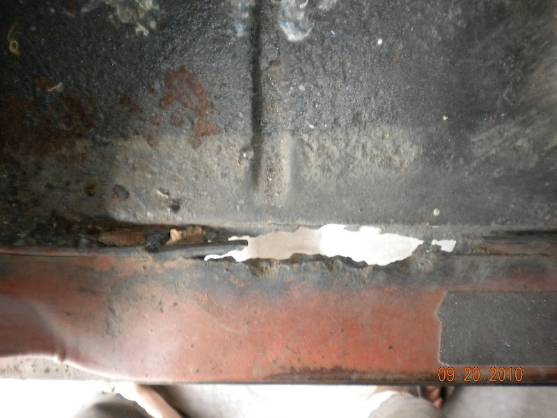

for those who thought I may be cutting up a cherry Suburban...

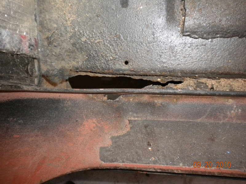

I found another issue with the frame... it is fixable if I keep this frame.
I am waiting on machine work to get done on the block for the Yukon, so I had some time to spend on the body of the Burb. I started by checking the cancer on the drivers side floor. I knocked several holes through the metal with my wire wheel. On the passenger side there is a screwed-down patch that was hiding under caulk and insulation. So along with the 4th door the Burb is gonna get a whole new floor and rockers...
Then my distraction woke up...
I am really procrastinating getting my welder working... I need to get the body braced before I cut anything out.

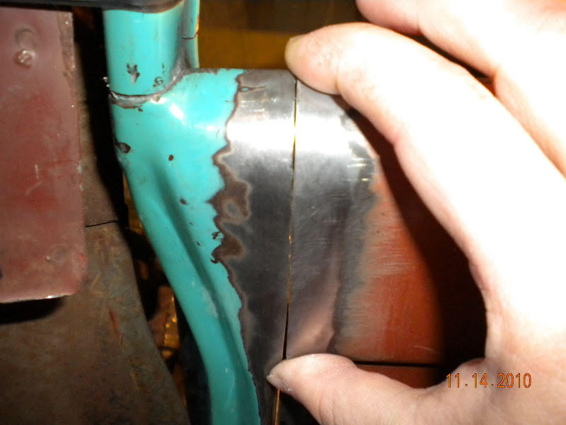

very minor update. got the first donor door... I'm still looking for a donor right truck door to cut up. I want a right one for the contour. Truthfully though, I haven't been paid this month so I am broke and out of shielding gas. So I am waiting on that before I start welding anything back together.
Being out of gas gives me a chance to get the metal fit perfect.
