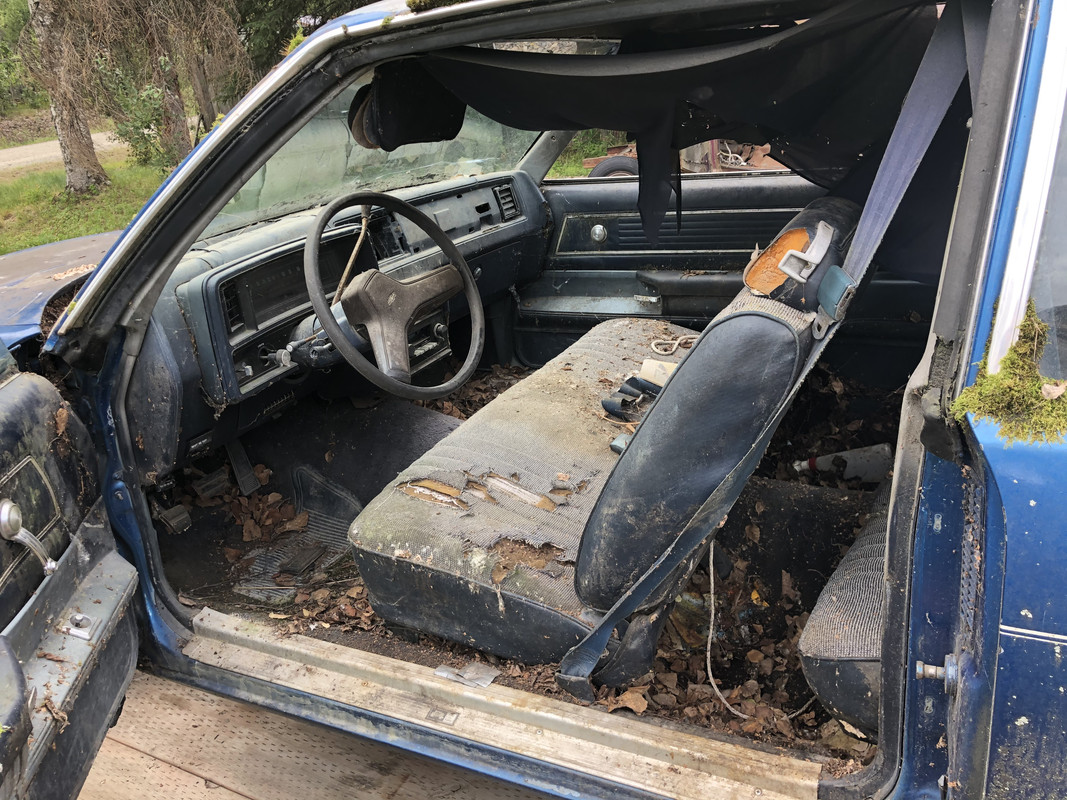

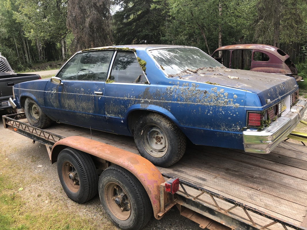

This is what it looked like when I found it literally sitting in the woods. Paid $100

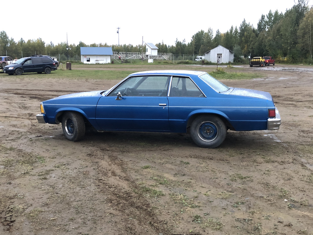

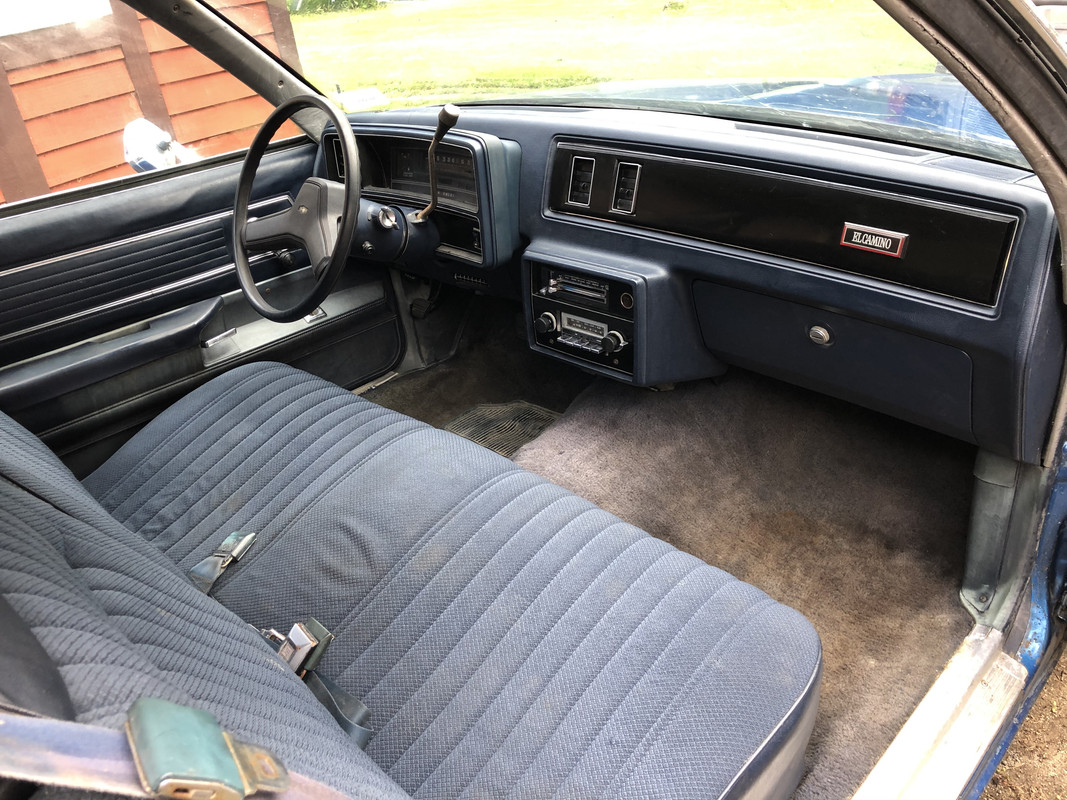

And this is what it looked like when I sold it. There was a LOT of cleaning involved:

That Malibu looked very nice vs what you started with. Lot of scrubbing there!

Thanks! I actually ended up replacing the entire dash and front seat on that one. Everything else cleaned up pretty well. It had a 267ci engine with a TH350. It got a carb rebuild, new plugs, wires, cap, rotor, and ignition module (module failing when hot was why it was parked for 18 years!). Changed all the fluids, new brake booster, master cylinder, calipers, rotors, shoes, drums, and hardware kit was all it took to get it going. It ran like it never missed a day on the road!
