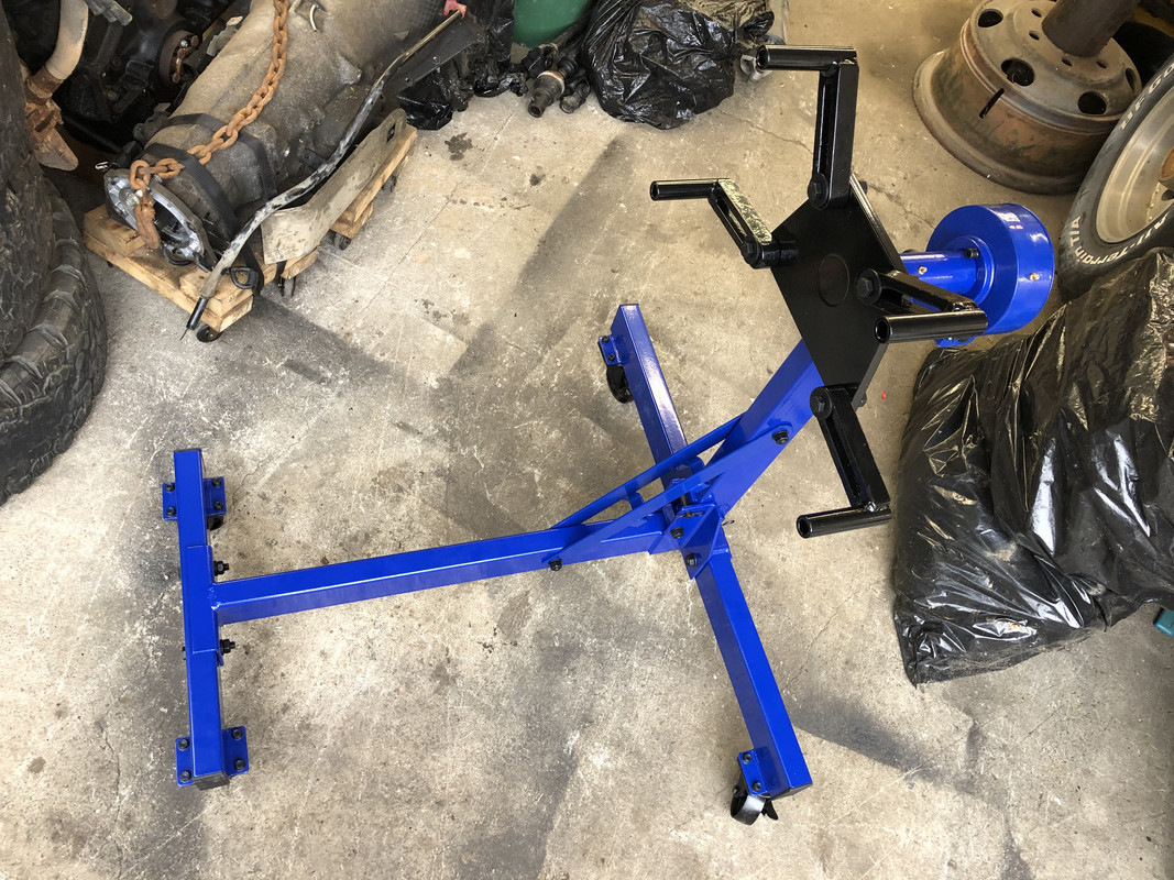

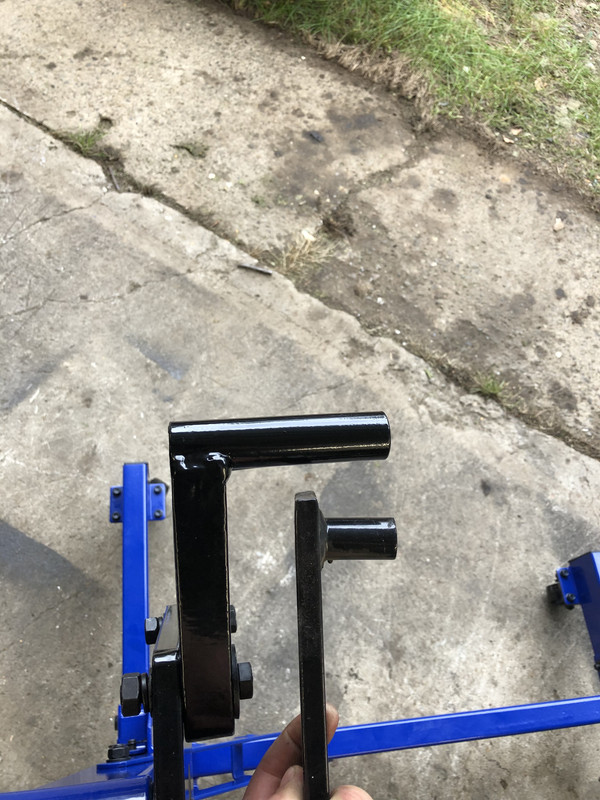

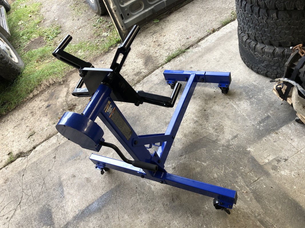

Bought an upgraded engine stand since a Big Block now exists in my shop, and I don’t put much trust the cheapo stands. The gear drive head is amazing, I should’ve invested in one of these years ago.
Here’s the real tell - difference in arm size between the standard and new arms!

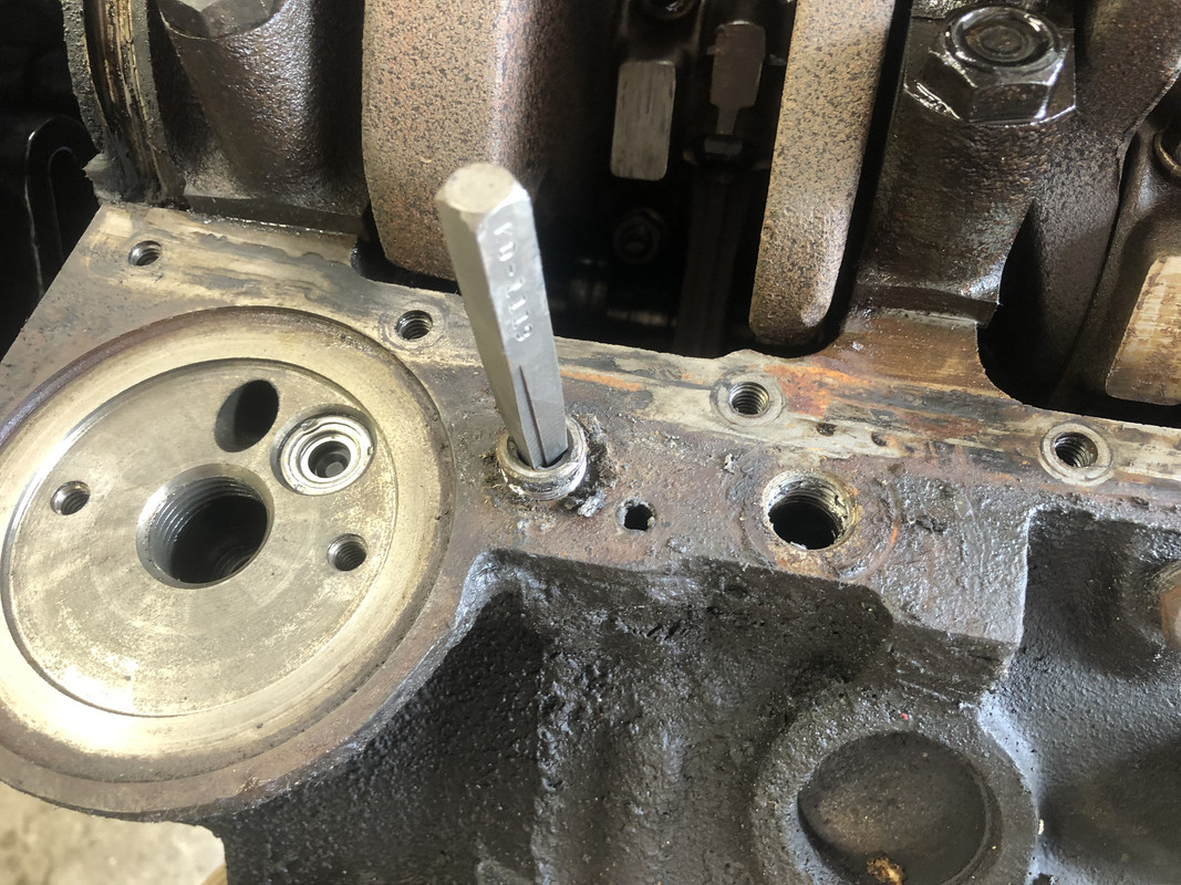

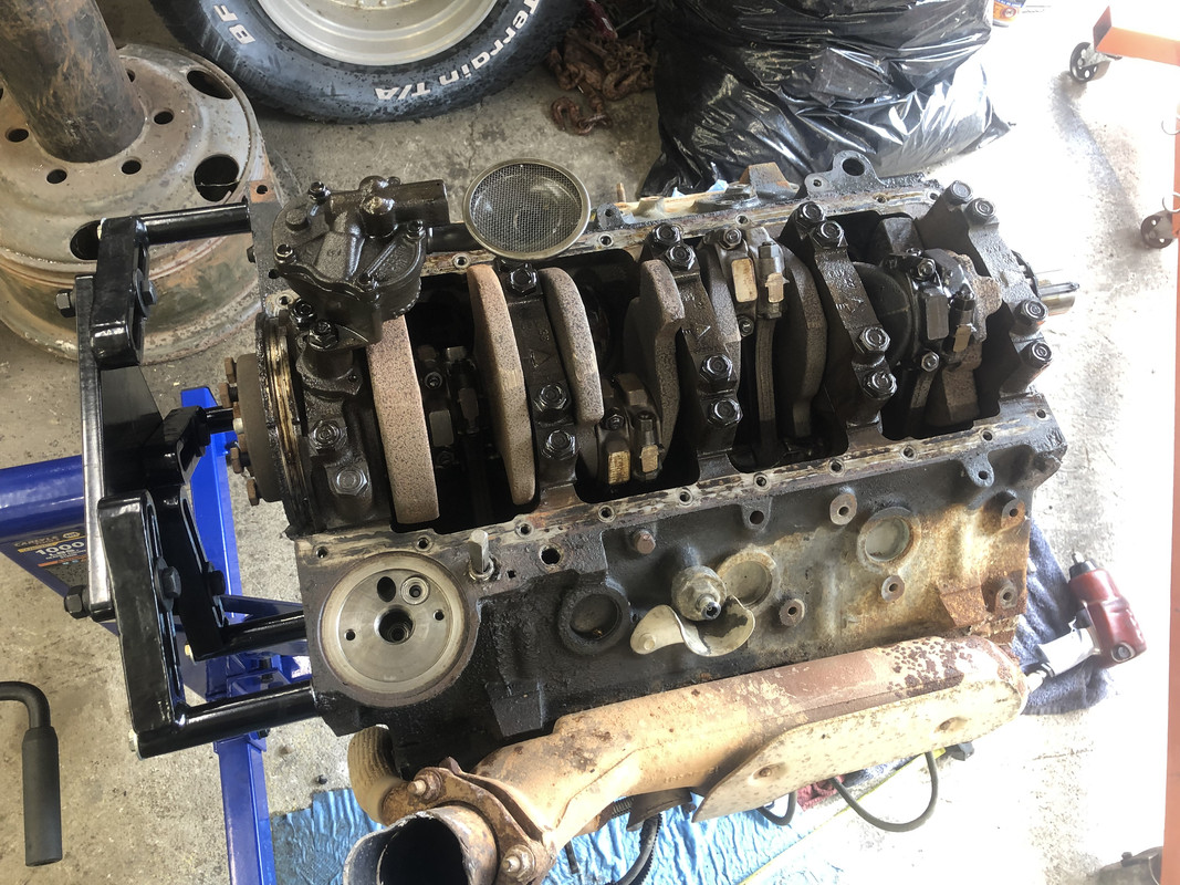

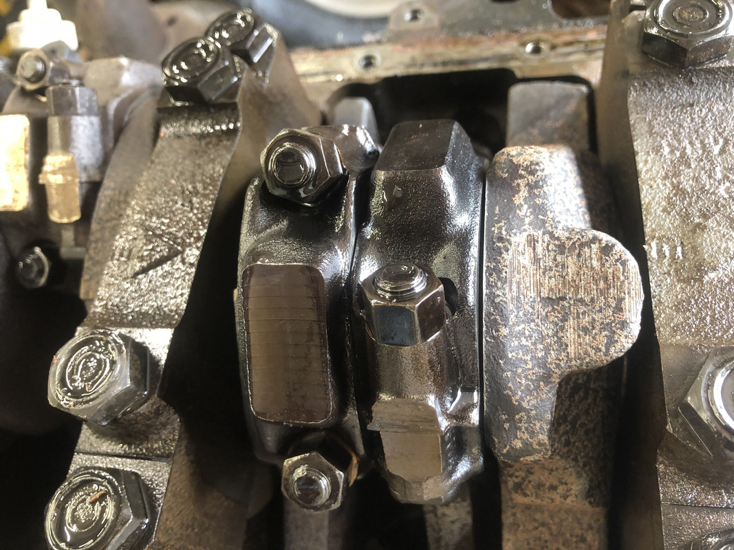

I got a chance to inspect the VIN today, and it looks like I have a 1997! I also threw the 454 up on the stand today, and again I can’t emphasize just how nice this crank is! Spins over a full iron BBC like it’s nothing! I pulled the water pump, balancer, timing cover, and oil pan to check out the crank.
Sure enough, #1 is loose.
I also extracted a broken oil cooler line fitting from the block.

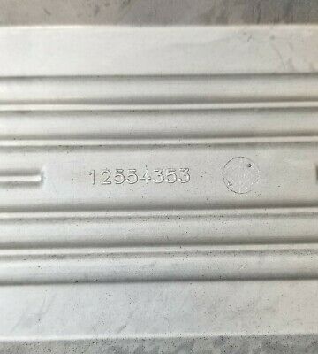

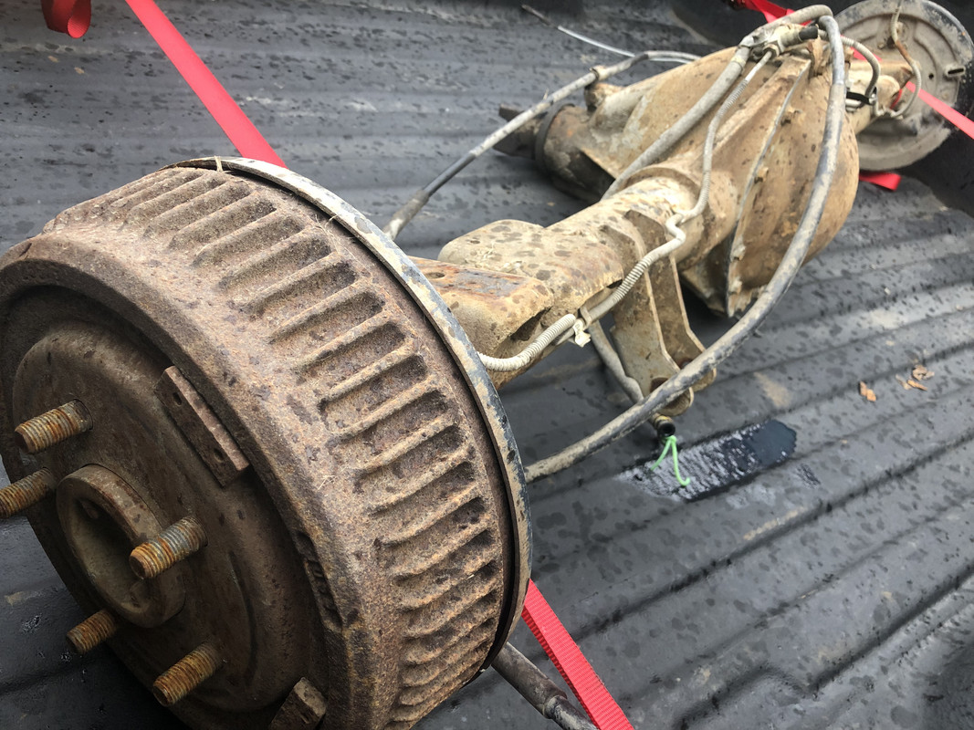

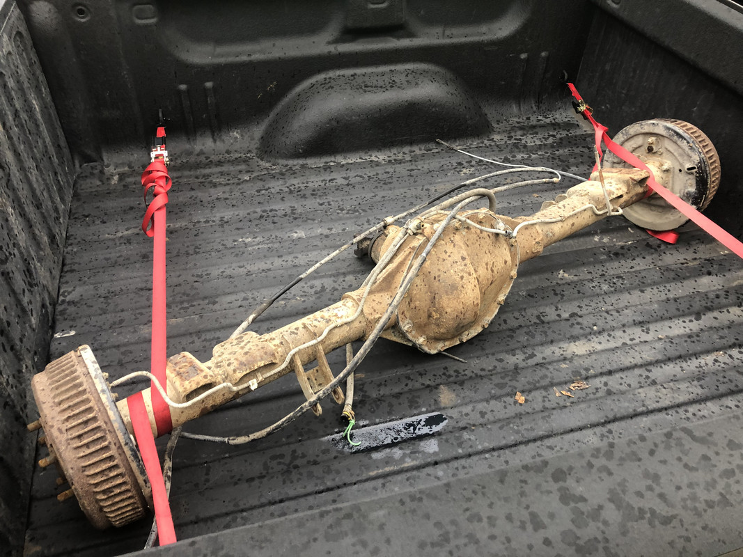

I made a huge score today! I had found a light duty (6 lug) 2WD 14 bolt rear axle locally, and had planned on pulling it this weekend. I figured I can get custom shafts made for it to convert it to the correct 5 lug. However, today, THIS popped up on Marketplace, and I couldn’t get down there fast enough! A REAL 454SS rear axle! Not only that, but the seller told me it was pulled (along with the engine and transmission) at 40k miles for a twin turbo 5.3L build! To top the deal off, he let it go for only $200!!
Proof of the real deal!

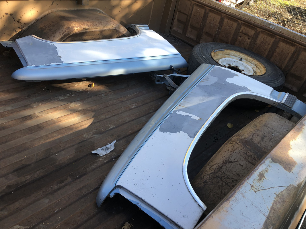

I scored again today, I snagged a pair of perfect condition front fenders on a Suburban sitting about 20 feet away from the 454 donor Suburban, for $150!

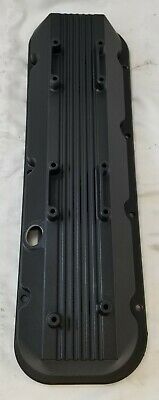

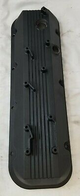

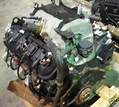

Alright, it’s been like 3 days since I’ve bought anything and I needed my fix, so I found a verrrrry interesting pair of 454 valve covers for $120 shipped! Does anyone recognize these? In case you’re not aware, the L29 (your typical Gen VI Vortec 454) had a fairly unknown twin, the L21, which came in the medium duty chassis trucks for a short period. These 454’s came with some interesting LS-like features, such as a 24x reluctor wheel instead of the typical 4x, coil-near-plug system including the unique valve covers, and a capped, gutted distributor for the 1x cam signal. It ran off an early 97-98 LS1 PCM. Pretty interesting and rare setup!
And this is the L21 in the wild. Note the staggered coil mounting under the throttle body for clearance, which differs from the 8.1L.

I threw the new front fenders on the truck just to be able to have them stored safely for now. Plus, it’s looking less and less like a parts truck!
