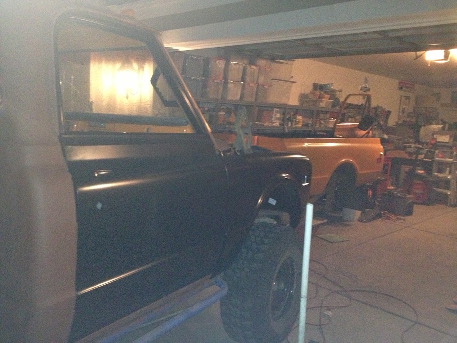

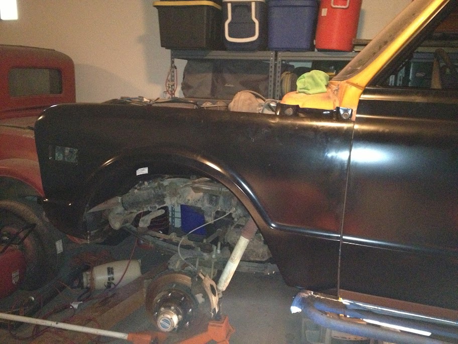

IT IS ALIVE..... was able to start it up and back it out of the garage so I could get the right side put together last night.
The right side actually went together easier than the left side did.
And tonight, I've got a couple of friends coming over to assist with the hood and the bed..

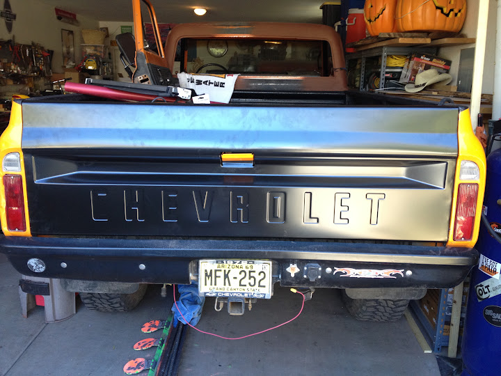

I also put the new tailgate on the truck. The old one suffered from the typical bow in the middle, and it was rubbing my rear bumper, which had managed to scratch all of the paint across the back.
The handle was dirty, but no rust on it...
It ended up lining up nicely.
Required one quick bit of trimming to clear the latch on the driver's side.
And like I said it was a good fit, but not perfect.

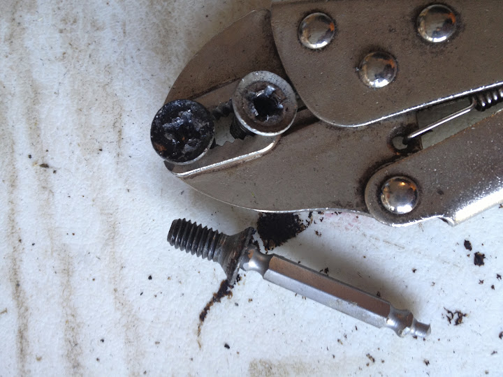

One last thing, and I may post this on the main board as well. How the hell do you get the door latch mechanism out of the door? I've been using an impact screwdriver (ex 1), and had the screws (ex 2) sprayed with WD-40 (ex 3) over the last two weeks, and nothing... any hints?
Ex.1
Ex. 2
Ex. 3
-Scott

Well, I reached out for some advise on the Message Board, and they had some good information. I thought it was good anyway, and started to tap out the screws. Well, I broke two 3/16" bits and ended up getting frustrated. But a pictorial version of my steps are as follows:
Step 1, swear at the door latch.
Step 2, remember that a friend bought you bolt/screw extractor set (that you put in the back of the tool box because you didn't really think that they'd work.)
Step 3, select a shiny, never been used 5 year old tool that hasn't ever been out of the case but looks like it'll slip down into the phillips screw recess with a partially wallowed out 3/16" hole.
Step 4, find the big-arsed crescent wrench and a pair if vise-grips and twist.
Step 5, place door latch assembly gently on table so as not to find yourself spending $50 to order a replacement.
Step 6, offer the old door a humble apology.
Step 7, have a beer, because I actually accomplished something today.

Ex. 4: And if you didn't see it in the picture above, you'll get a better idea with this picture.
Ex. 5: So, it looks like I get to spend my weekend cutting out the following.
I'm guessing that I'm going to have to find a way to take out about 1/4" of the lower part of the window channel, which would probably be about equal to the 1/4" that I had to lower the back part of the window to get the door to fit.
Fun
