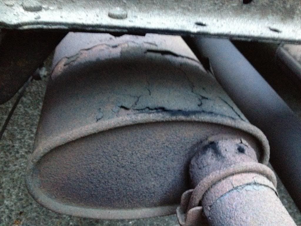

Well, things have progressed on the wrong end of the truck and before winter set in. The rear end has basically quit life and I decided to pull the bed as well to make it easier...and, of course, I might as well clean the frame and, and, and, and classic snowball. Haha.
So tonight I pulled the box and took some photos. This is the factory exhaust from 1978 except that the original owner added corvair turbo mufflers in 1979. Can't believe they held up this long. Also, he lowered the truck the same year by re-locating the spring perches. ![]() ![]() ![]() ![]()
