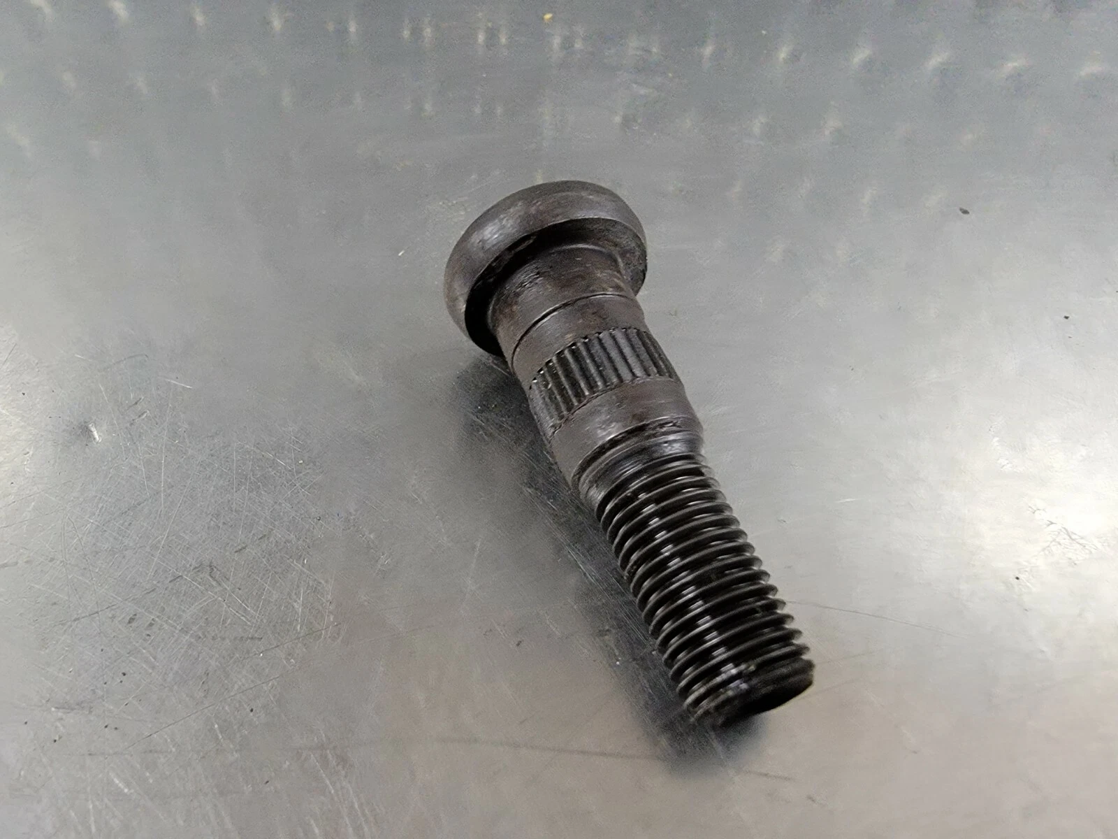

I measured the thickness of my rotors. One measures 1.250 and the other measures 1.230. Seems odd that they are that much different. Anyway, the minimum is 1.215, and new they were 1.285, so one is down to 50% and the other is at 21%. I'm just going to replace both of the rotors. I pressed out the studs and freed my one good hub from the rotor. I should be getting the replacement hub for the other side early next week.
pjmoreland is online now   Reply With Quote
Old 11-21-2024, 11:50 AM   #19
1970cstblazer
1970cstblazer's Avatar
Join Date: Jul 2003
Location: Elkland, PA
Posts: 2,500
Lightbulb Re: 1971 K10 Stepside - Getting a Roller Roadworthy
When I replaced the rotors on my 1970, I was able to source the 12 studs on Ebay. I did not want to use the currently available Dorman pieces.
Raysbestos 5020b, GM 3995841, Wagner BD60908
Thank you for the part numbers. I ordered 12 of the Wagner units off eBay. The studs I removed are all slightly tweaked from being pressed out, so they definitely need to be replaced.
