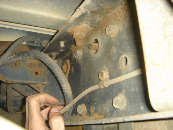

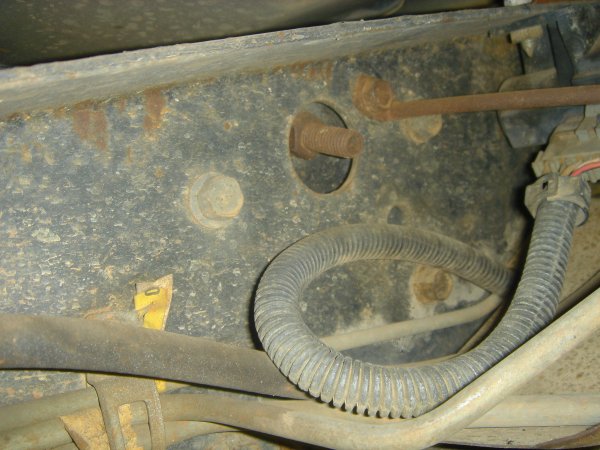

I am working on a write-up of this, but here is a picture of the 8 frame bolts you need to remove to drop the tank. You DON'T want to remove the straps.
In a nutshell, drain the tank (a low as possible), pull the filler/vent hose, put a jack under the tank with slight pressure, remove the rubber fuel lines from the frame lines (or selector), remove the ground strap,

Thanks for the pics. I'm going to have to get back up in there and look again. I thought it looked awful tight between the frame and the tank to get a wrench on those nuts to drop the whole assembly.

Based on what you are telling me I think you are talking about the strap nuts/bolts which you DO NOT want to remove. You want to take the 8 bolts marked with red arrows out.
