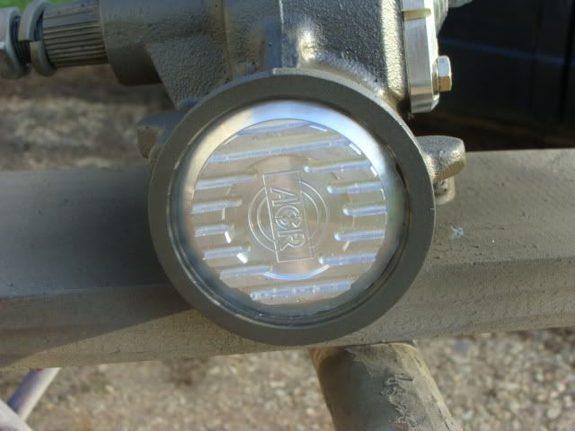

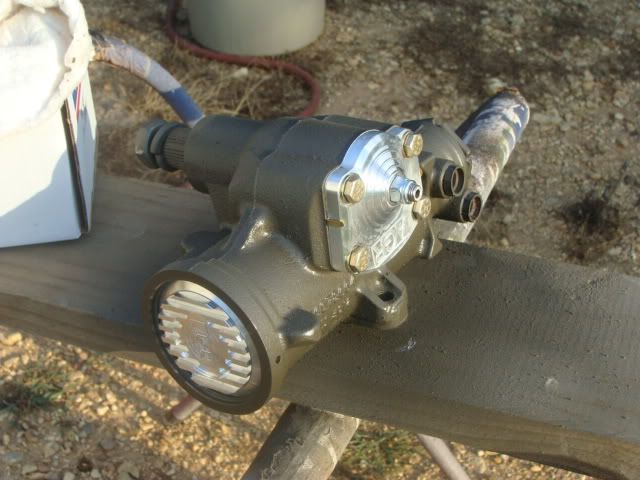

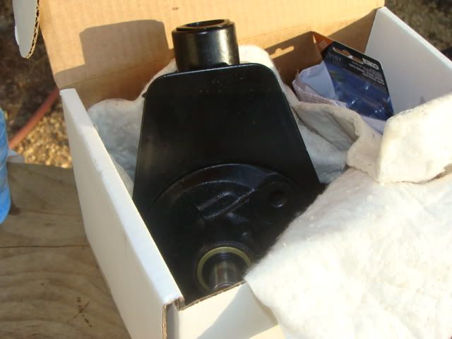

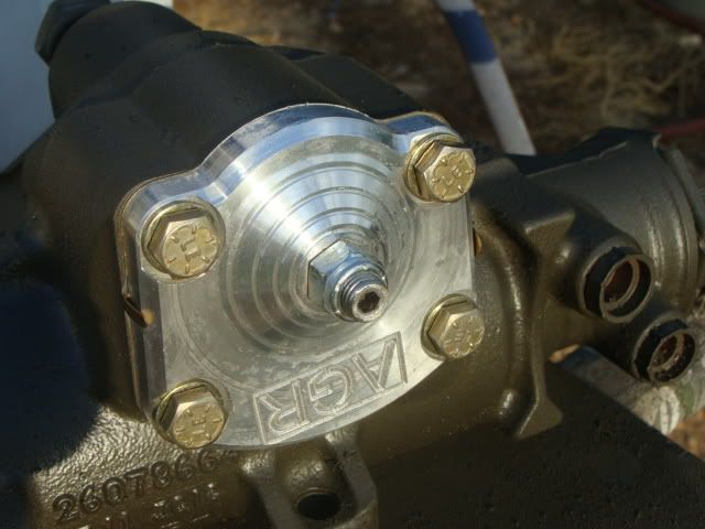

Her are some pics, can't see it once its in the truck. Comes bear metal and I painted it cast grey and gloss black on all the others stuff I replaced.

Well an update, Still running the AGR box and i like it but I still had a little bit of slack somwhere. Went ahead and installed a 2" suspenion lift which consisted of new keys and add-a-leafs. Really like it will post pics and partnumbers later. Found the slck it's in the steering shaft. Looking at replacing just the u-joint in the shaft. will get it off and do some measuring to see what Bourges (sp) has that will work.
Any tips are welcomed.

How much was AGR box and whats Jeg's part #? I see casting # of 26078664 in pic.
Man......... I don't remember the part #. I called AGR 1st and asked what box I needed just to make sure I got the right one. Best memory they make one for off road use only and a street version. I got the street one. Call AGR and they'll set you up.
