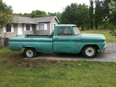

Picked up this project on Sunday. It followed me the whole way...
First project. Just getting started. Had a 69 in high school. learned to drive a stick on it. I want to keep the inline 6 and 3 on the tree for nostalgia.
Bed is just sitting on the frame in the picture. It is pretty much toast. I have secured another bed for it on the cheap so i may scrap the current one. Plans are to get it running and driving asap and get the new bed on it and enjoy it then do upgrades as i can for a bit. Have a shop to go and weld patches in as i go. Longterm.. tear it down and do a frame up.. time will tell

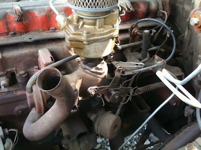

okay. a bit frustrated and maybe this should wait but i have a question.
So i drop the truck off at a shop because i want them to run through the engine and hook up the carb and throttle linkage for me. (BTW thanks to LILRED66. Perfect part. Cleaned up and everything)
Well go to drop the part off and he says one of his guys took a look at the engine and its not original and is off something later model. He used as his determining factor that it had an "integrated head." Now it has been a month since i looked under the hood and should probably go and take a look.
Question is this. do i try and make this "newer" engine work with my newly found linkage and make a runner even though i have never heard it running. or, as the guy at the shop says just try and find a late model truck with a 350/350 combo and drop that whole thing in there.
I am trying to just get a cheap farm truck running and take my time building what i want out of it.

posted on the engine forums as well and go what sounded to be a lot of bad news. lots of thinking and drinking to do in order to come up with a conclusion. Plan for now is to get this guy up and running with a new linkage of some sort. (because as you can see it is buggered) Once it is running an i have a useable truck i will begin putting together a new engine for my rig.
Question now is to do a 6 or an 8. fuel efficiency is a concern but not paramount. if i can do around 15mpg then i would be tickled pink. so 3.08 gears and now to find a proper carb engine combo to get me there. sigh... the search begins.

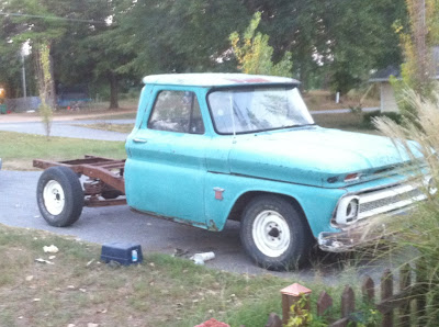

GREAT NEWS! Got my truck back. New carb and linkage more appropriate to the engine and drove the ol girl home from the shop. Then proceeded to take the girlfriends two boys 8 and 6 for a ride to the end of the road and back. Needless to say I am fired up. Time to get it road worthy and driving.

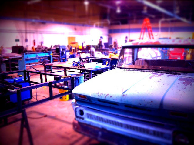

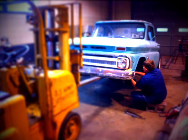

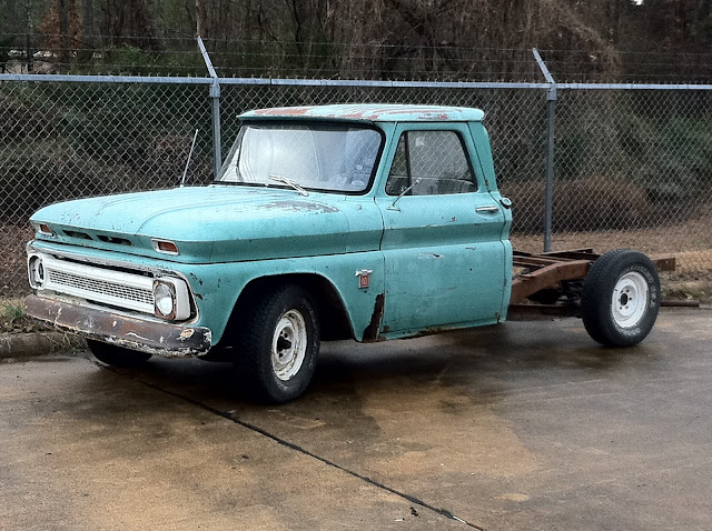

After a bit of advice from you guys and some parts from Jeff at CPP I have the truck down 3/5 and have plans to throw together a flat bed for the time being to get the truck legal and drivable. Couldn't have done it without the local Vo/Tech Teacher and the shop he works in. All the tools you can imagine and some I wouldn't have imagined. I am excited but you guys want pictures the same as I do in a build thread so here they go.
Fun Picture of Shop
My helper.. also known as the guy who did most of the work. Perry.
The rear end finished. trackbar, springs and shocks
Finished product. The front actually came up a bit due to two broken front springs.
Quick and Dirty version of where its headed after the Christmas Break

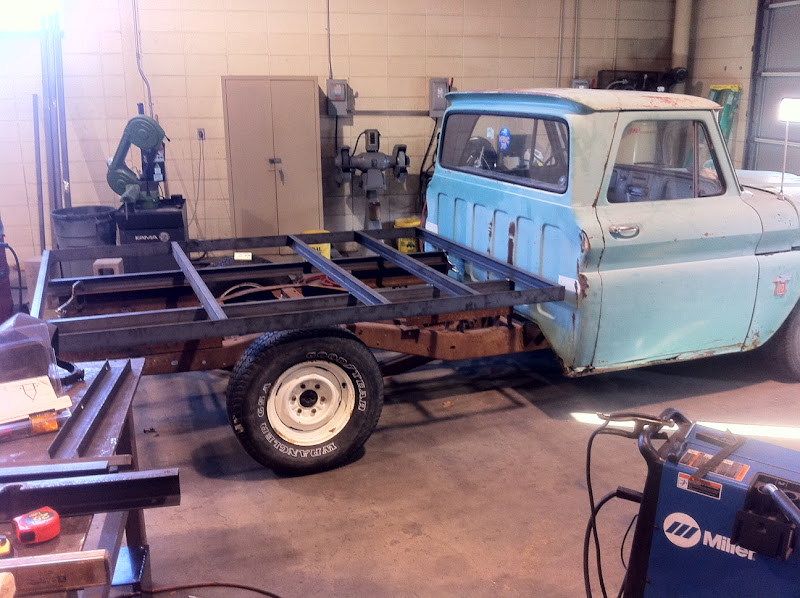

Got the bed laid out
Then got on to finish welding, adding the 14 stake pockets, a bumper/hitch and tail lights
Got the wood ordered for the bed and sides so waiting for a day to paint the frame and bed and ready to finish it up.

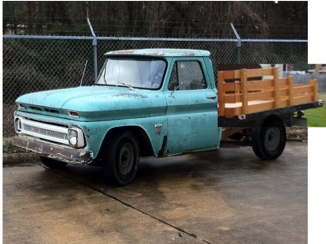

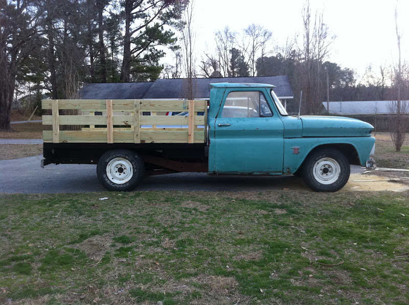

Well I got it painted and mounted up for the last time and got the wood on the bed Friday. Saturday I built the sides for it because the weather wouldn't allow me to stay in the house. When it was all done we loaded up the two boys, the hound dog, the mother-in-law, and the fiancée and went for a ride. The boys loved it.
I still need to get some brackets for the corners to I can attach them to one another.

Then Sunday the weather did it to me again so after a morning at the park with the boys out came the Wax. I thought that I would pay someone to cut and buff the truck at a body shop but decided in the end that I had the time and the wax so why not see what I could do. Above the body line is waxed. Below isn't.
Not bad so I kept going.

I like it! You made a really cool hauler for practically nothing.
A cheap set of 6-lug truck rallys painted the factory argent color would really set it off.
Another truck saved!!

Loving the flat bed! I wanna build one for mine too. I've got a '63 BBW LWB Fleet. If you don't mind me asking, what kind of metal did you use for the frame? Was it just channel?
3 inch channel for the rails and cross pieces, 3" flat stock for the sides, 4" channel in 2.5" pieces for stake pockets, and finally ended up with 5" channel between the 3" and the frame so the bed would clear the tires. It is on 5" drop springs and the bump stops are sliced in about half and still clears.
I am switching to the 4" HD drops soon to get some of the sag out of it's rear.
If I can help or take picks for you let me know. I am about $200 into it all said and done.

Yea if its no trouble I'd love to see some pics. I wanted to build one and put a diamond plate floor on mine but the diamond plate here would cost $200 alone and it would take 2 sheets. My dad and I both thought bout the stake bed idea but wasn't sure how it'd look on these and were worried bout the wood rotting. Now that I know how it looks I want one! lol LOVE the old farm truck look!
