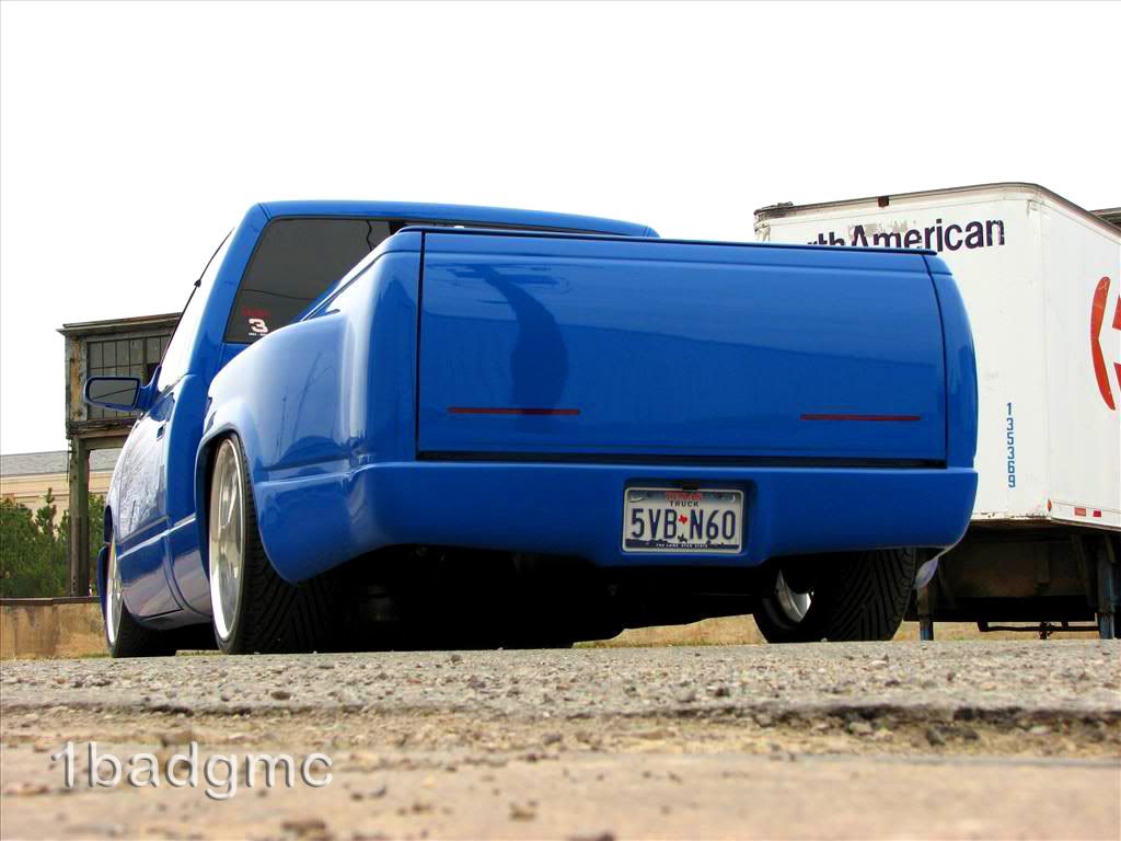

That's a tall and wide tire, but it should be ok if you trim/roll your fender lips.
I've got 20x10s with only 6" of backspacing. Granted my 285/30 tires aren't quite as tall or as wide, but the extra little bit of space your backspacing gives you, you should be able to make it work with only 6" of drop.

Re: 6" rear drop and 20's?
Originally Posted by k5hart View Post
I would love to see your pictures. Thanks
Here's a shot of my fit...
