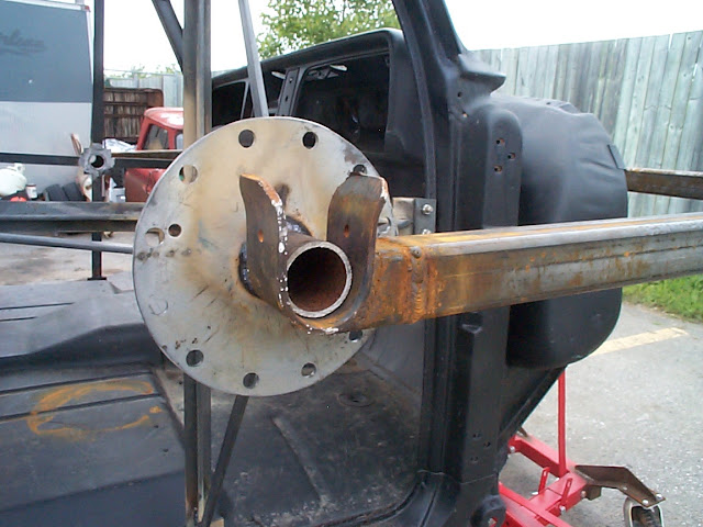

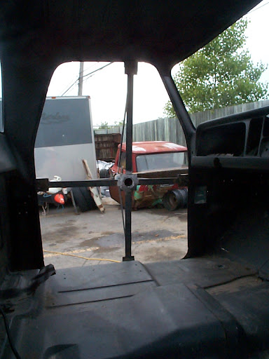

Now I've seen a through the door rotisserie from another member ( Misled ) and thought I could build one similar. One criteria I was trying to find the balancing point of a bare cab. So I took some 2x4's and placed the cab on them to determine a rough balancing point on 4 sides. Theres a horizontal crease behind the striker for the door, this point of reference balanced the cab while it was laying on it's back. Hindge side there is again a horizontal crease where the cowl extension bolts to the pillar. At the roof line where all the sections come together, measure back about 2". Under the seat section where it begins to drop to meet the floor where you place your feet. Then I connected all these points to find the intersect.
Misled' s design
New Design features.
Now in his design there's a bulk of metal all around the working area in the front and on the sides. I would like to minimize the obstructions surrounding the cab so that you have the freedom to work without tripping over anything. There has to be horizontal bars on each side of the rotisserie vertical posts to balance, but if you run a pipe through the cab connecting each vertical post, you can eliminate the need for one under the cab. Would this be to much of an impediment for blasting and painting the inside of the cab?
You need 43" Diameter from the center of the pivot point to allow the cab to rotate without touching the ground.
It should be mounted on four large air filled casters so it can move across pavement and grass.
Should be able to lift the cab off the ground to a comfortable working height for installing new rocker panels and replacement floor panels, yet remain low enough to roll the assembly out of an 82" height garage door opening.
I'd like some input/ideas as to what you think would benefit/improve the concept.

I like the simplicity of Misled's design, but would make a couple of changes. Eliminate the center wheels, they are redundant. And replace the two lengths of angle iron with a center brace. By not having the center wheels you can run the center brace that is just above the floor, giving you enough room to clear the cab. With that you don't need the center section of the tube. It would also be nice to have things set up so you can stand with your legs through the back window and work behind the dash.
Fred

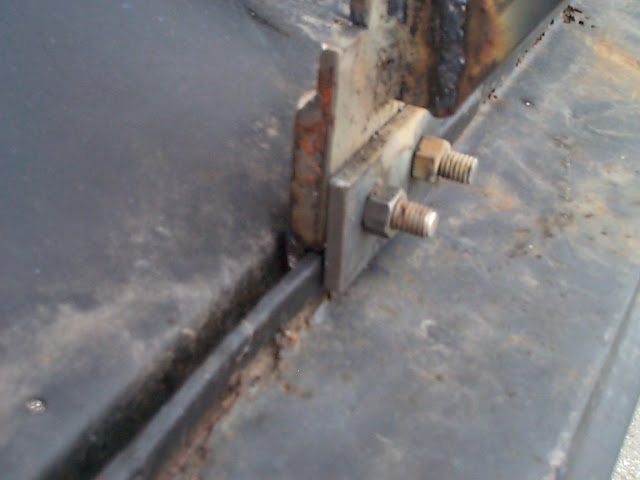

They may look redundant, but they're not.
They actually help to stabilize it from tilting toward the cab because they're closer to the cab.
Here's the one I built last fall without the center wheels. It has a 3/16" 2x2 square tubing that connects the two pieces and runs through 2.5x2.5 tubing under each half which is adjustable for different cars. But, before I use it again it will have center wheels. This is a 70 Mach-1 (not a real heavy car) but without that center wheel, it makes the 2x2 span piece sag about 1", or maybe more in the middle. I would never have guessed that 3/16 would flex like that, but it does.
If you look right under the tail light, you'll see a piece of 1/2" all thread rod with a "t" welded on top and a 1/2" nut welded on the side of the 2.5x2.5 that I added to try to correct the flex. It works fine, only problem; it has to be loosened every time I move the car outside.
It's not a huge problem. And maybe I'm over cautious, but I'll be adding center wheels before it's used again. Probably right about where that all-thread is now.

Re: Cab Rotisserie Thoughts.
Is the chain and turnbuckle to relieve some of the pull on the mast?
Old 06-06-2010, 10:09 PM   #19
63 & 64 Bowties
and a few others
Location: Blue Ridge Mountains of VA
Posts: 5,638
Exactly. Something that was kinda done without thinking things through.
I was never worried about the integrity of the rotisserie, but worried about what was happening to the car when the tops of the rotisserie leaned in about an inch or more. This is a unibody car and I was worried what was happening to the door alignments when it was on it's side.
