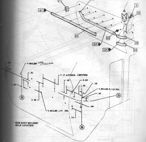

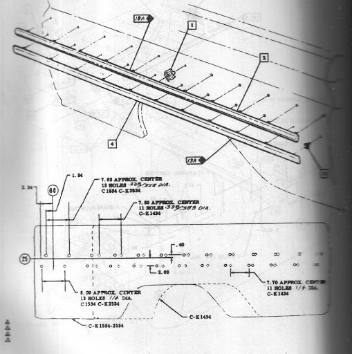

I'm looking at a '66 longbed to buy, but it doesn't have the side trim. How hard would it be to put the trim on. the truck doesn't have them so theres no holes.

And this may help also, some discussion related to the above diagram:
http://67-72chevytrucks.com/vboard/s...ide+trim+holes
