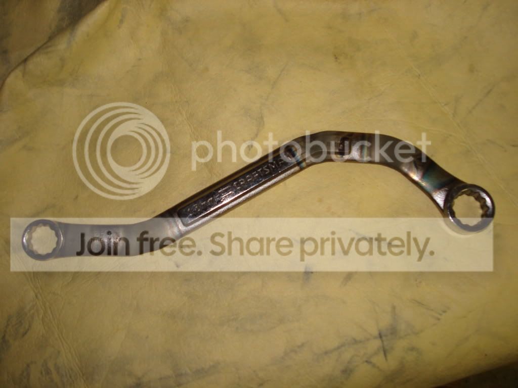

The "Special" timing pump wrench is similar to the Ford/Chrysler starter bolt wrench. I've seen a few home brews... like this box wrench bent with a vise and torch. To save $100 I'll bend up a $10 Craftsman.
