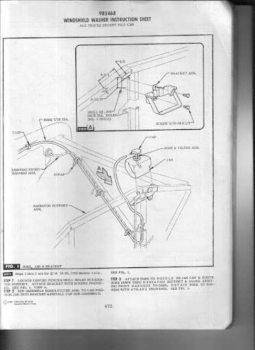

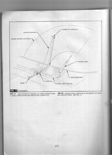

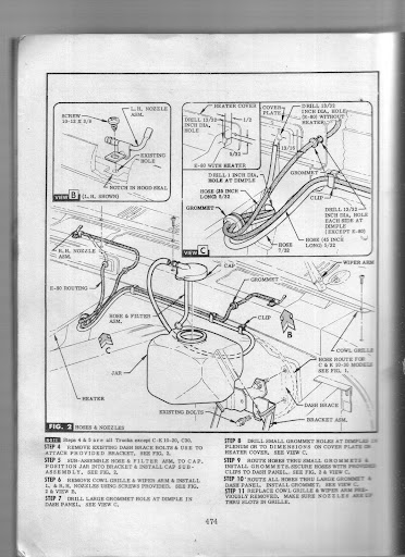

As far as I know they weren't "standard", but believe they may have been optional from the factory. The ones I've seen have a push button in the wiper knob, and the nozzles squirt through the cowl vent. I don’t know where the factory pump is located, but in general I find them too troublesome and expensive to deal with. I found a pair of factory squirters in the wrecking yard, and hooked them up to a momentary switch and a standard aftermarket electric pump similar to this:
http://www.ryderfleetproducts.com/cg...mpaign=product
And here’s a link to the factory switch, although I don’t see the pushbutton knobs listed as available:
http://www.classicparts.com/1964-66-...ctinfo/67-648/
And here’s where the nozzles go. They are similar to later model vehicles being a piece of small tubing with a crimp in the end:

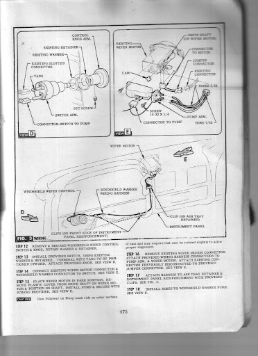

the pump is actually part of the wiper motor, I picked mine up at a pick and pull before anybody got to it...This is in comparison to a new port wiper I found on line
