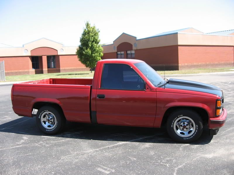

Don't really know how much it has been lowered. The po added mono leafs and coils. Still has stock spindles, shackles and hangers. Any idea on the stance? 2/3 or 3/4?

Throwing a guess.. 2-3 maybe?

I'd guess 2/3. The tires look pretty normal size. Good looking stance for a driver.

A full-on side should would help to judge better. Your tires look like they're maybe 275/60s. Those tires are around 3/4" smaller diameter than stock. Your front fender gap is very similar to what I have on my Suburban with a 3" drop and stock size tires. I'm going to guess a 3/4 drop.

Thanks guys, I was thinking 2/3 also. She not a daily, all project. So, looks like I'll be buying some suspension parts to get her down to a respectable stance.
I would guess and flip over mono leafs would not be a good idea. So back to factory leafs, flip kit w/ c-notch and 2 in. spindles up front. Then roll the front fender lips.

I guess a 2/4.

With that pic, I'm going to guess 2/3 or 2/4. It gives a better perspective. You could consider adding some shackles and a c-notch and some spindles to get it down. Just a thought.

Yeah im going with 2/3, Nice truck tho.

You could consider adding some shackles.
Great Idea, I have a set of Bell Tech hangers and shackles sitting in the corner.

It works. I had a 5/8 drop on my truck for years using shackles, hangers and leafs.
