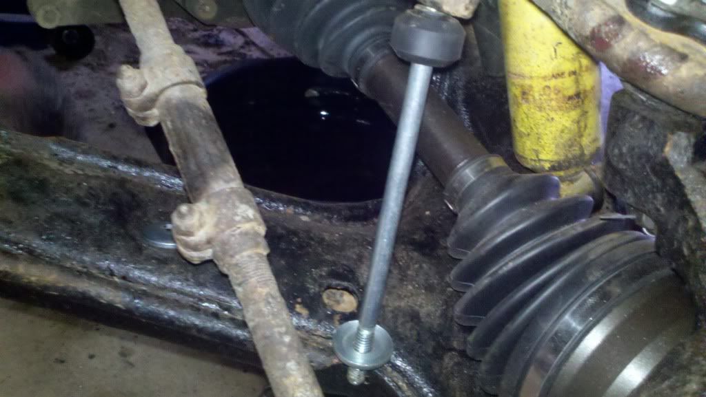

1990 chevy truck stabilizer bar bolt assembly
how the heck do you get this in. tried jacking, prying, even swearing
my husbands threatening to blow my truck up!
hope i got the right termanoligy. heres a pic. thanks in advance.

I never had a problem before, but best bet, loosen the other side and try, if not then you're gonna need to loosen the front and that side, or maybe even disconnect the other side and get both started. The bar aint bent is it?

Is it lowered? They make different sizes if they are lowered or not. Have you tried jacking it up and taking the load off the control arms and trying that?

problem solved. had to loosen ball joint to get it in. thanks guys!
