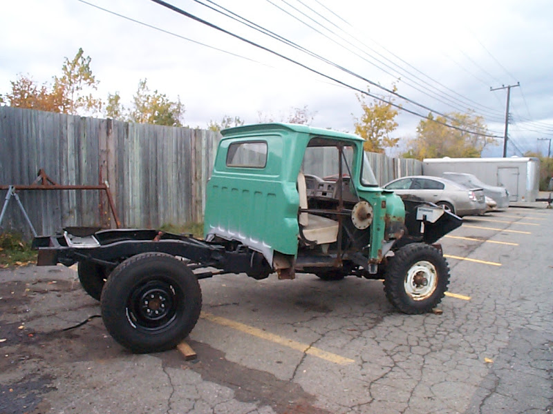

This is an original 16" wheel for our series.
I widened mine to 9 1/2".
Stock steel 16" off 70's truck on the front. 17.5" converted to 17" on the rear.

Well I talked to a guy whose been around wheels and tires all his life. The only issue you might come across is air leakage through the rivets that hold the center section to the ring. You might paint the inside of the wheel rivets to seal them. The Air Valve will have to have the larger diameter base so it will seal in the valve opening. Your wheels are the same as the white wheel picture above.
