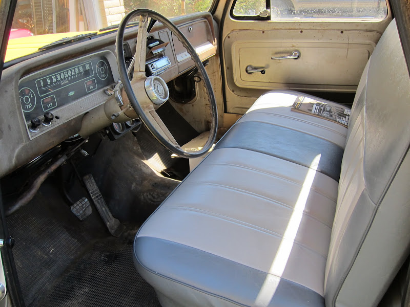

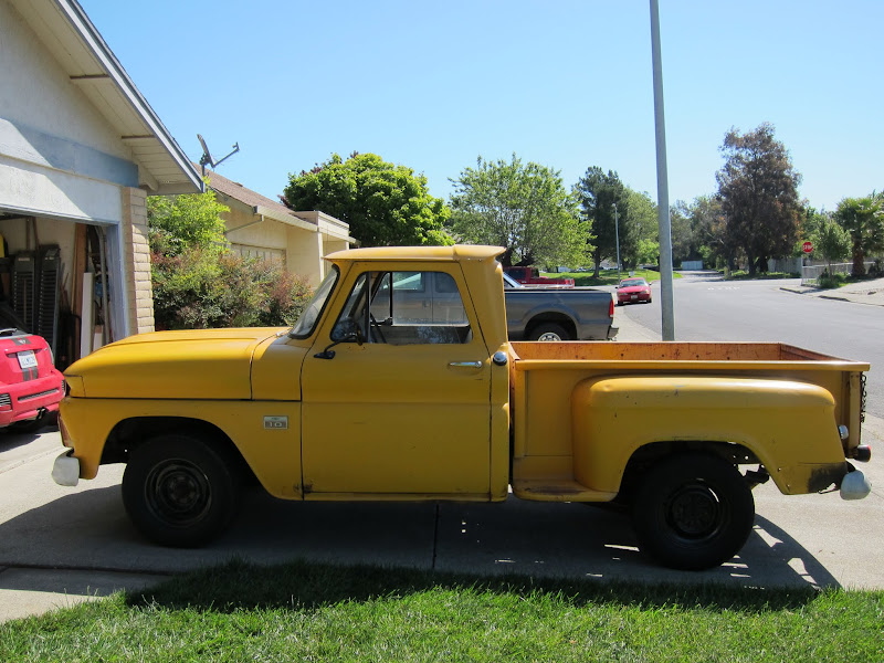

Here's my 66 I just bought. This truck was on a ranch about 10 minutes from my house. Looks like they were the second owner and have had it since 1974. It was last registered in 1991 so it's been 20 years since it has seen the road. It's been many years since I have had a auto/truck to restore/refurb so I am pretty excited to get started on it. It is a runner and has a 327/TH350 in it (not stock). So I am going to try and keep it running more or less while I work on it. That may be a challenge in itself. How to restore it while all the time staying within a day or two of having it a road worthy truck. Anyway, here are the Day 1 pictures>
It all needs a good going through but it did come with a few new parts. It has a new gas tank, radiator, brake master cyllinder and booster, seat upholstery, tires, and bed slats. It also came with a HEI distributor and an alternator the PO hadn't got around to installing.

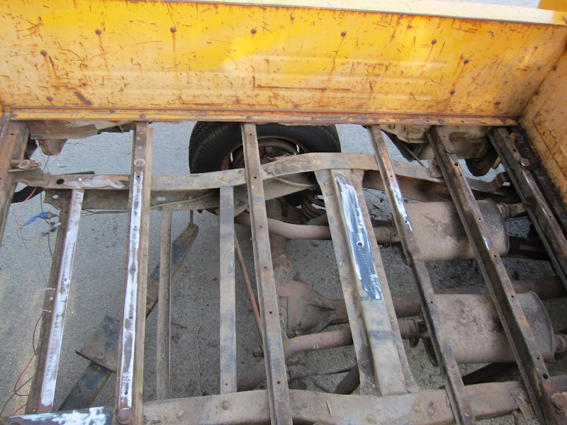

The bed was completely eaten by termites. The first thing I did was take a cutting wheel and remove all the bolts for the bed slats. Than removed the slats and wood, or what was left of the wood. Time to use some elbow grease and start cleaning the frame and bed supports.

Clean truck! Looks like you've got a strong start on it, but, unless I'm missing something...the fenders that came on the truck look to be in great shape.
It's nice to be able to drive the truck as you work through it, I find I enjoy it all that much more.

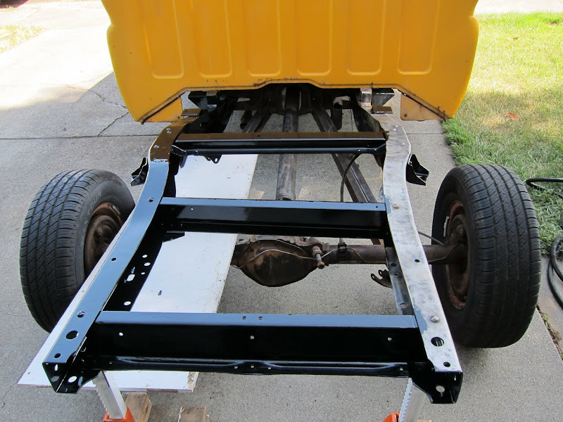

Finally I can show a little progress besides sanding off rust! I started painting the frame today with POR15. I am super happy to actually start seeing results after weeks of sanding/wire wheeling. It's getting fun now.

I got some more cleaning and painting of the frame done this week. Also removed the brake lines and one of the trailing arms.

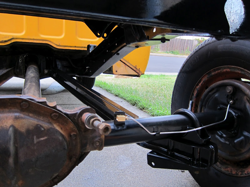

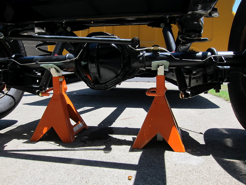

Finished the trailing arms, painted the differential,springs and u bolts. Installed everything. Working on the bed now.

Working on the Brakes and differential. Pulled off the diff cover, removed the axles, brake pieces and brake backing plate. Replacing the diff seals, wheel cylinders and brake shoes.

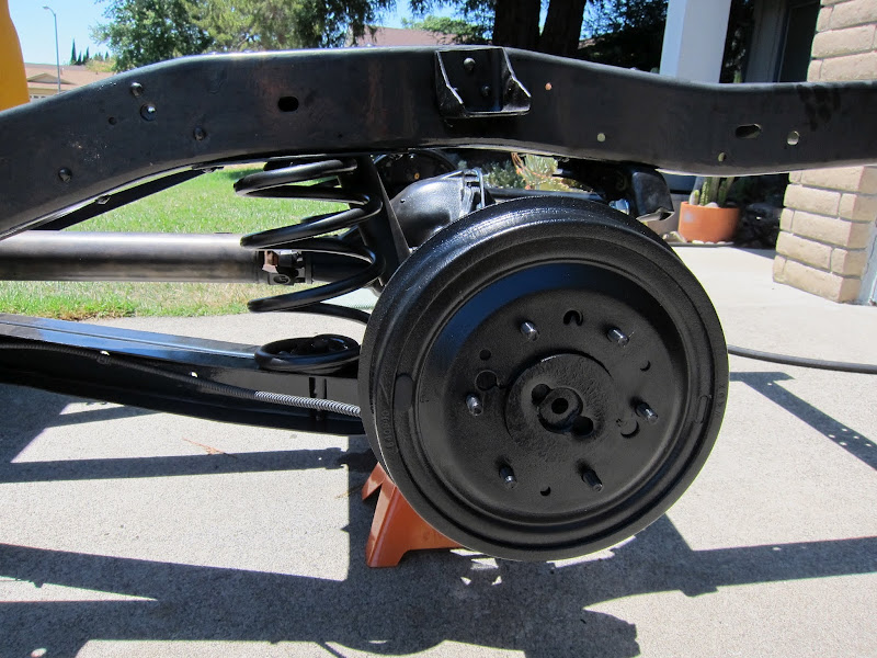

Here's my latest. Rebuilt the rear brakes. New brake springs and wheel cylinders. Springs were installed backwards by whoever did them last time. The brake shoes were in perfect condition so I didn't bother to replace them. Pulled the axles, replaced the axle seals, cleaned and painted everything. I also cleaned up the emergency brake cables and painted the ends where they had rusted before.
Painted the drums. Something I found interesting is that the drums have a locator tab on them that is supposed to align with a hole in the axle hub. I searched the net but couldnt find a technical reason for this. To me it would seem there would be no difference which way the drum was mounted to the axle hub.
Installed a new adjustable track bar and stainless brake lines. The rubber brake hose I bought from Classic parts was the wrong size to screw into the brake line on the frame so I had to order one for a long bed for some reason, hope it's the right size.
Still working on derusting the bed rails and rear cross sill.

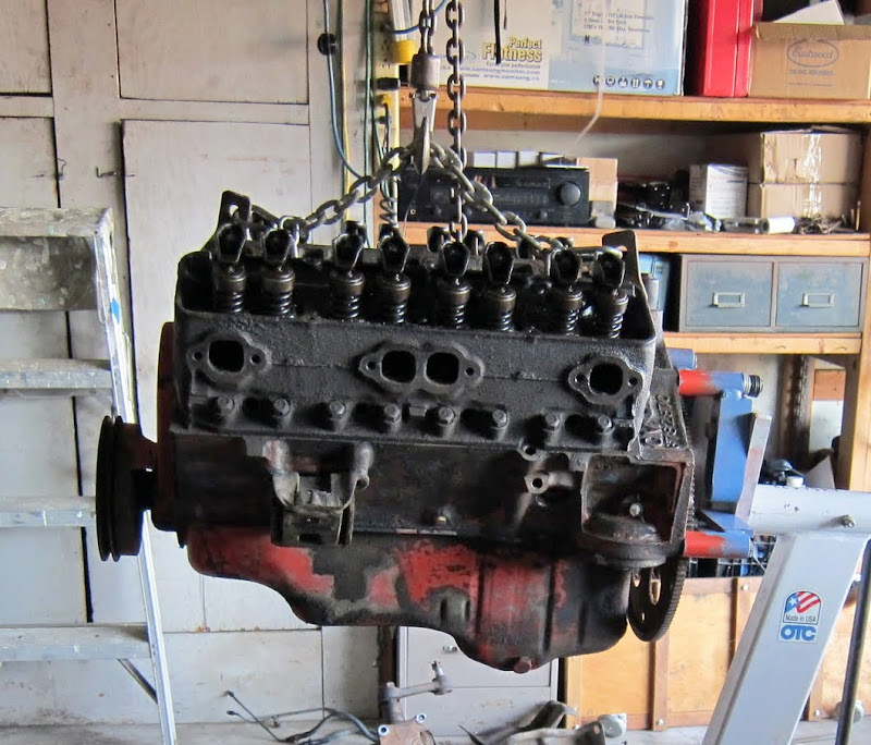

Thanks for all the encouragement Stripped down the engine, I will be pulling it out this week.

I have been delinquent in updating my build. I have made some pretty good progress. First I got the engine pulled out.

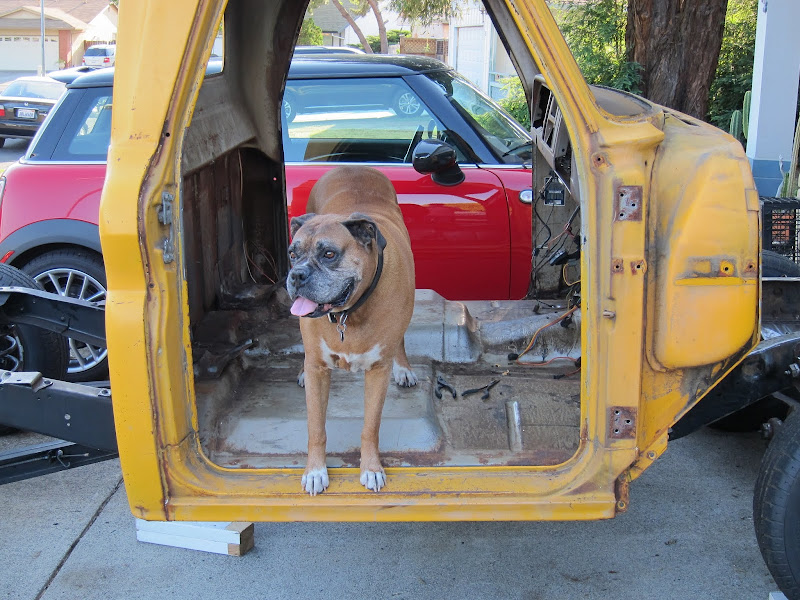

Stripped the cab down to a shell. That's Monkey, he's there every day keeping me company.
And finally removed the cab. Now the frame is all mine to attack with a wire wheel haha.

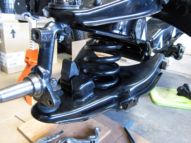

Removed the steering and suspension. I will bereplaceing most of it.
