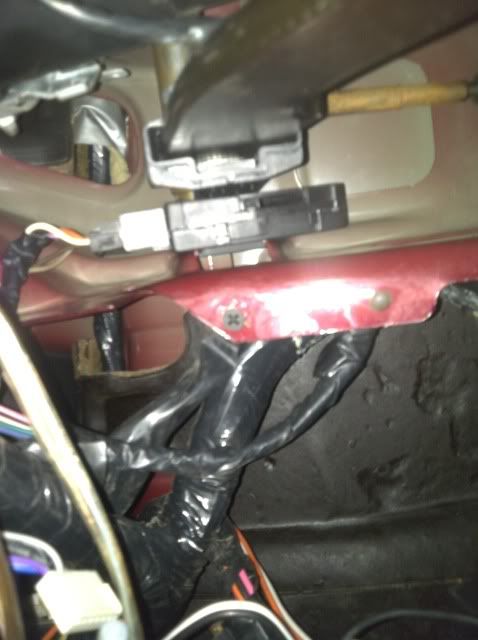

and that this is the cruise control connection that i should be testing(from the turn signal/cruise/wiper stalk on the steering column)?
the connection in the background illuminated by the light?
p.s those are the non-connected wires i was talking about;
1.anti-lock brake suburban only(not worried about that one, mines not a suburban)
2.vehicle speed sensor buffer(im hoping this isnt a problem
3.daytime running lights(not worried about this one either)
again thx

The brake switch you posted a photo of is not the switch I was referring to, but the wire colors should lead you to the correct circuit.
I can't tell what connector you are shining a light on, but the cruise connector is very small.

Check it at the connector in the bottom photo.
If I remember correctly, the truck in the post I gave the link to had the wire broken in the column where the wire bends from the tilt and not up by the top.

so i t appears i have both the clutch switch and the brake light switch.
1988 GMC c1500 SWB D/D RHD 5.7L 700R4
burkey05 is offline   Reply With Quote
Old 08-27-2012, 08:04 AM   #24
ChevyTech
Join Date: May 2004
Location: Minnesota
Posts: 4,621
Re: cruise control
That switch in the top photo is a high failure part. If you ever have brake light or RWAL problems, be suspicious of that switch.
Lets us know how it goes when you get the new parts.

ok, thanks for all your help so far ChevyTech.
i'll post up results once i get the part.
its got me intrigued now why i have both the clutch switch and the brake light switch!! i might do a bit of testing etc over the w/end to see exactly what function the clutch switch is providing. i can see that the one wire goes from the clutch switch to the brake light switch, and then from there to the cruise control module........................
