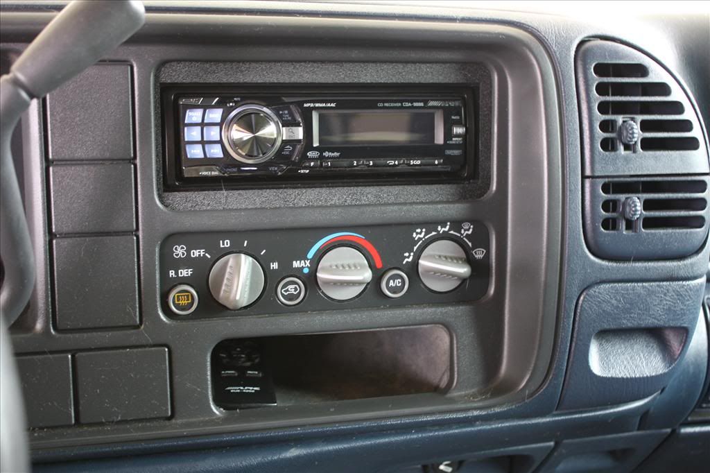

here is what I was rolling with stock.... pay no attention to the aftermarket radio above, but the disc slot below the HVAC controls plugs into the back of the factory radio. You probably will have to get a newer model stock radio to hook it all up, but should fit in your dash as my dad's 95 dash has that extra cubby hole where my CD player was/still is.
I still have the factory radio in the barn, if you need more pics of that. Also should note there where two styles of radio for these trucks, some slid in and unclipped with tabs and some bolted in. So take yours out and see what style it is before buying a "new" stock radio. Its kind of set up like a component system... guessing because the CD player was an afterthought in the later years of production and didn't want to change the dash. Also this doesn't have an AUX input. so you'll need one of those casset adapter things for Ipod connection.

I honestly tried to resist going with aftermarket in my Suburban, but I finally gave in. I wanted to be able to play MP3s and I had this Alpine laying around with a USB port. I got a dash kit that mounts the unit nice and flush, which I do like.
Plus, the blue display of the Alpine works very well with my blue LED cluster and HVAC controls.
