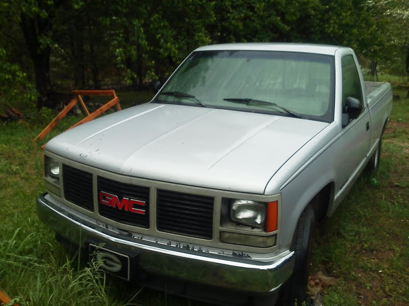

Well been looking still for either just the fenders... or the bed... which Ive been searching 400 miles from my location... which I still havent found anything cheap that is...
Craigslist hasnt been helpful... any ideas???? thanks

http://www.duallyfendersfiberglasstruck.com/#CHEVYGMC
About half way down the page. 525.00 for the pair.
This one is getting the phantom dually treatment when the 4.3 dies and I do a LS/6spd swap. I've had the fenders for it since 96. LOL
