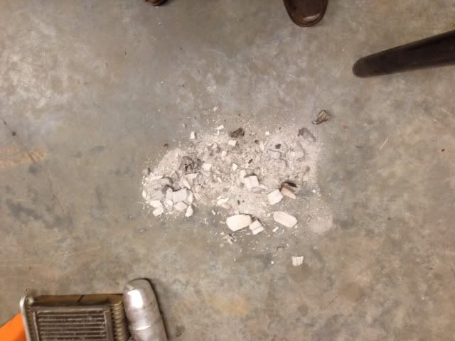

First thing I set out to do was address the cat. My thought was just to cut the back of it off, clean it out, then reweld. Much to my delight, there was a flange on the back of it and I unbolted it (2 bolts is much easier than welding )
So the cat definatly has some clunking around going on. This is what fell out of it:
So with it cleaned out I went to re-install it. Cleaned up the edges with a wire wheel on the grinder and started welding it back in. Because of the orientation, seeing from about 10 o'clock to twelve o'clock was not possible. What to do? I broke out my Iphone and used the front camera so I could see where the mig wire was, put the phone down and made a tack weld and then moved on to the next one. Isn't technology great!

Hey now a burned plug wire will definately hurt the idle quality and fuel consumption. I bought an 88 GMC shorty that idled terrible but the truck was solid. Once going it seemed to smooth out pretty good. Long story short, I bought it right and went straight home and did a tuneup on it with new wires, cap and rotor. Smoothed it right up. One of the boots had a split in it and was arcing over to the exhaust manifold.
Man that cat was full of crap! I wonder how much of it was blown downstream into the muffler.

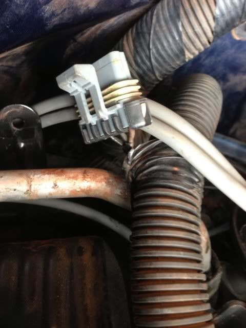

What's this connector to? ESC maybe?

Check your wire going into the map, and check to see if it has a 5/32 regular hose going to it - it The plastic hard line leading to the map usually gets replaced with regular hose or is broken and it will cause the truck to run like crap.
The ESC is usually right next to the power brake booster and is 5-pin.

Connector has a black, black/white, and brown wire.
Looking at the wiring diagram for the engine, I didn't see a sensor with those three wires. I did note that all of those wire colors are used as grounds at some point.
