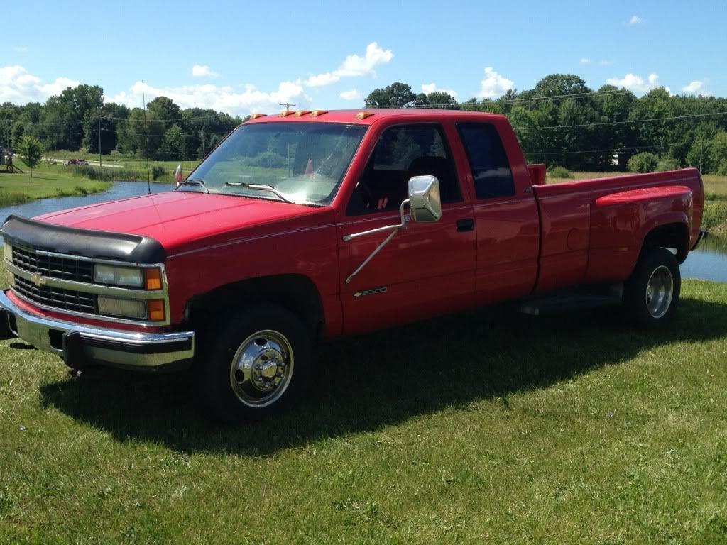

Super appreciate all the insight and feedback. I'm getting the inside clean and removing what's left of running boards. Her is a pic

That is a beautiful truck!!! All you gotta do now is yank that bug shield off, compound it and your good to go!!!
Thanks. Funny as I was very close to talking the bug shield off tonight while washing it for the first time. It got a lot brighter just with a wash...extended cab corners are rusting. Oh well I like it
