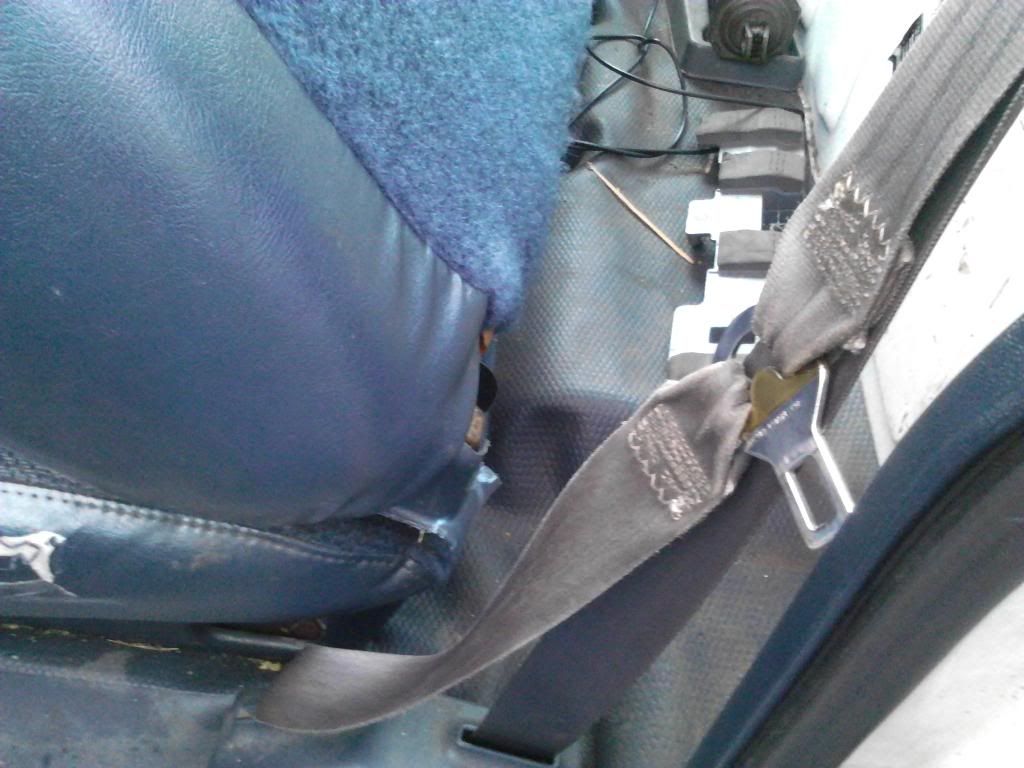

Sorry for the delay in posting the picture of what I'm dealing with.
I still seem to feel something is missing.
Rick
05 Silverado 2500HD. 6.0 engine
rickrod3 is offline   Reply With Quote

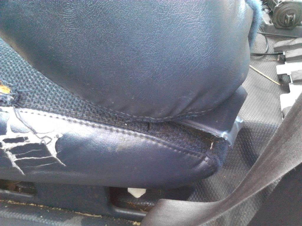

rickrod3
Location: Oakland NJ
Posts: 28
Re: Bench seat not latching
The seat is not in great shape. I was calling around to junk yards. what other years and models will fit? I saw the thread on Gm Bucket seats but; I would like to keep the bench seat.

the seat you have is designed to "latch" in a sudden stop/crash under normal use it is designed to fold forward to allow access behind the seat , it looks like it is working as designed . look behind the blue plastic cover and you will see a moveable bracket with a bolt going thru the top that allows it to swing forward and latch but at rest/stopped it should allow the seat to fold forward . Use a flash light and give it a good look you'll see how it works .Also find a local auto upholstery shop to fix your seat and pad it for your comfort the cloth material on top is reasonably cheap and vinyl is also .much less expensive than replacement and the shop can show you how the latch works for free !
