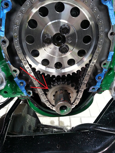

it backfired on cold starts and took for ever to crank it it the morning. checked the HEI BAT terminal and it only got 11.4V and during cranking ot dropped to 7-8V. So supercharged the HEI by wiring it to the firewall terminal through a relay.
result:
no more backfires
cold starts in 2-3 rotations of engine in the morning
stronger idle

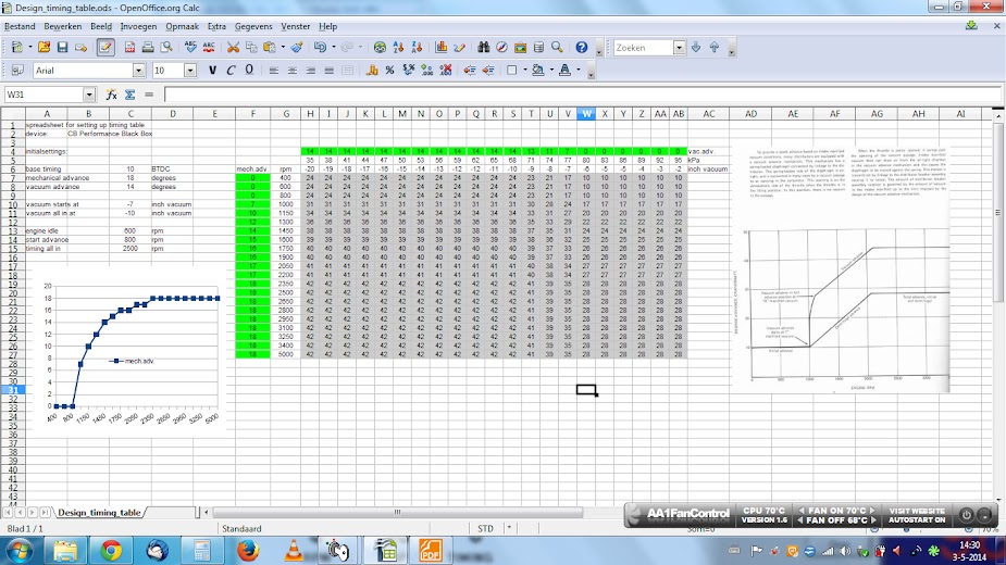

I recently bought a CB Performance Black Box for $175,-
pretty nice specs and hooks right up to my HEI ignition.
http://www.cbperformance.com/Product...oductCode=2013
Features
21 x 21 Spark Table
5 Bar MAP Sensor (good to 43 psi)
Adjustable RPM/MAP Load Boundaries
Low and high end adjustable rev limiter
4, 6 & 8 Cylinder Applications
Easy to use Windows-based Software (requires XP, Vista, 7 or 8)
7' Flying Lead Harness
Electrical Terminals Included
Serial Cable Included (some computers may require #2015 USB to Serial Adapter)
Instructions, wiring diagrams and Tuning Video on included CD
Conformal coated circuit board with surface mount components
Made in the USA
#2040 Vacuum Reference Kit recommended for Dual Carb Applications
http://www.youtube.com/watch?feature...&v=7qv87mFw6T4
cant wait to get it hooked up and start tuning

you can program a 21x21 timing map and have a couple of special buttons in the bottom to help.
I made a excel spreadsheet to help me design a timing map. I set a couple of numbers and it fills the 21x21 table

after breakin in the engine for over 20min. I tried driving it. It had absolutely no power at more then 5% of the throttle and vacuum dropped allmost immediately when increasing throttle. Vacuum at idle was just a poor 10-12inches.
after some research, pulling the intake and watching the valves while turning the balancer I found out I had the camshaft wrongly aligned
there is a inner and outer ZERO on the small sprocket. I aligned it using the inner ZERO....dooohhhhhhhh!!!!
see where it is about 20-30 degrees out of alignment
this is correctly aligned
