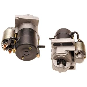

I've used this one on many SB and BB projects. AC Delco 323-485. 168 tooth direct replacement for the heavy old starters.
This commercial grade starter is actually the one I use on my Sub and K10. They are expensive but it will be the last starter motor you ever buy. The flywheel will wear out before this one gives up the ghost. Denso 281-8002... fits anything the AC Delco 323-485 will fit. Its really tiny

To add onto Larry's post about the factory mini starters. I took these pictures the other day when I installed one onto my beater stepside.
This is a 98 model Tahoe 5.7L fitment starter compared to the original type.The difference in size and weight is hard to believe until you see it in person. GM built some fantastic starters that you can buy at any parts store in America. I much prefer that to an aftermarket one from Summit or other mail order place.

Old 03-27-2014, 06:44 AM   #10
walkerb
walkerb's Avatar
Join Date: May 2010
Location: Rochester NY
Posts: 831
Re: Starter brace- 250 and 454- The same?
Originally Posted by DirtyLarry View Post
Unless there is some compelling reason why you really want to keep the slow heavy old style starter motor, the later model mini-starters are not only small and light, they flat out work better and do not need any bracing.
Both of these starters weigh about half of the stock slow spinning/low torque starters.

More difference than that I'd say. I can hold it up into place with the tips of two fingers.
I can't really fully describe the contrast in bulk between the two. When I got the starter from Rockauto, I unboxed it in my kitchen and just stood there mouth agape. I thought it was the wrong starter or something. It looks half scale.
Cranks like a bull though. Size has no correlation to strength of performance.
