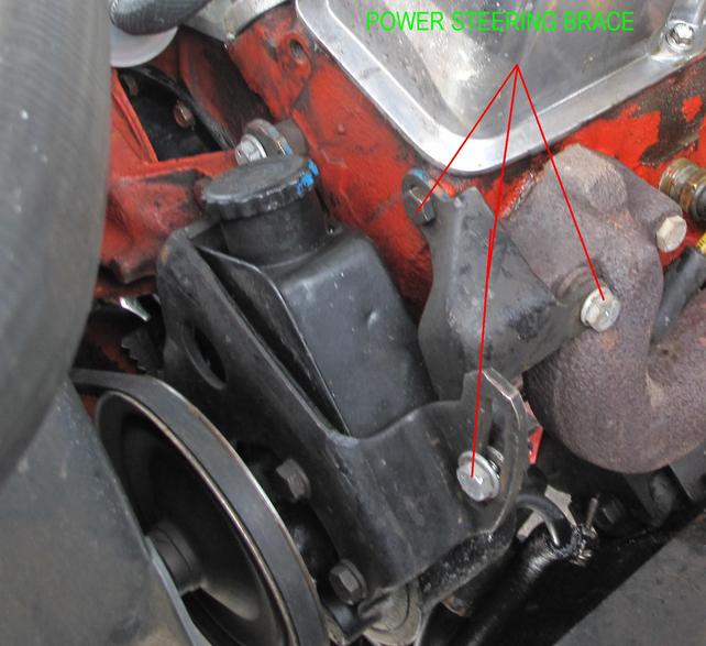

make sure you have this in place too,it can be tricky to keep tight if this bracket is missing

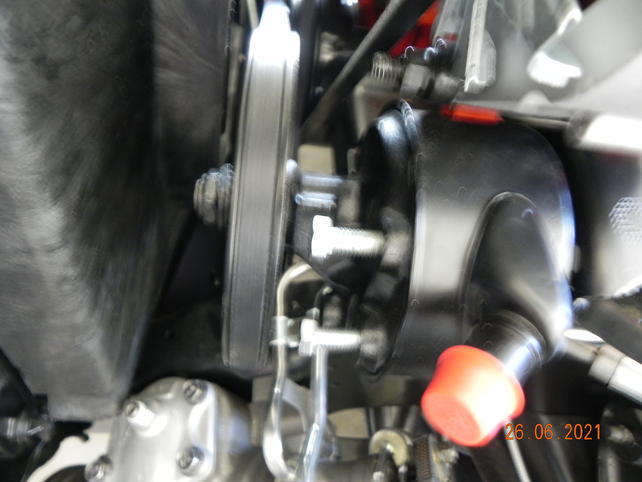

Don't mean to bump though perhaps this is of value, at least on the 71-72 BBC pumps there are two thread holes, I believe these are exactly for tensioning the belt, eazy peazy & no damage.
IMO do not pry on the pump housing at all, I've done it before but this time I cared

you dont need any special tools there are 2 bolt holes on the front of the pump behind the pulley just hand screw a bolt in there as far as you can use a 1.5' bolt and it becomes a leverage point you can then us a prybar to tighten it.
