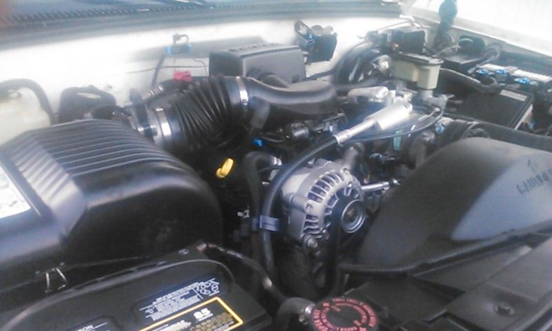

i went and checked out the used engine sounded good oil looked good ect, so i told them for 350 bucks id take it, while they were pulling it i went and yanked the engine out of the service truck went and picked it up, dropped the new one in and got it all back together, seems to run good. only put 20 miles or so on the new engine so far. did the swap in about 14 hours.
started taking down the old motor
engine out
new engine in and everything back together
i plan to tear down the old engine and rebuild it when i get some more spare time, and then if the used one goes ill have a fresh rebuilt ready to drop in or if i end up with another use for it, never hurts to have a rebuilt engine laying around.
