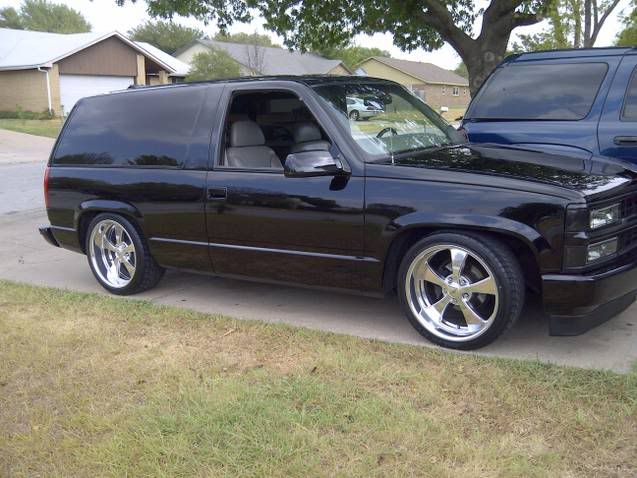

He's the ride that started it all. I found it on craigslist but can't get the guy to budge on the price. Figured maybe I'll just build one if I can use my wheels and tires.

Well good luck , I had the Eagle 225 wheels same as you and I was told they would not work with any kind of a drop so I sold them! The kicker is I have a bunch of picks with these wheels on dropped trucks . I'm in Phoenix away from my source of pics but I can post them up when I get back home .

4.5 bs in the front probably isn't enough.
I run between 5 1/4 & 5 3/4 bs up front.
(PS I want that Tahoe!)
These are 5 1/4 up front & I wish they were 5 1/2.

That's sweet! Those wheels are very similar to what I want for mine.
