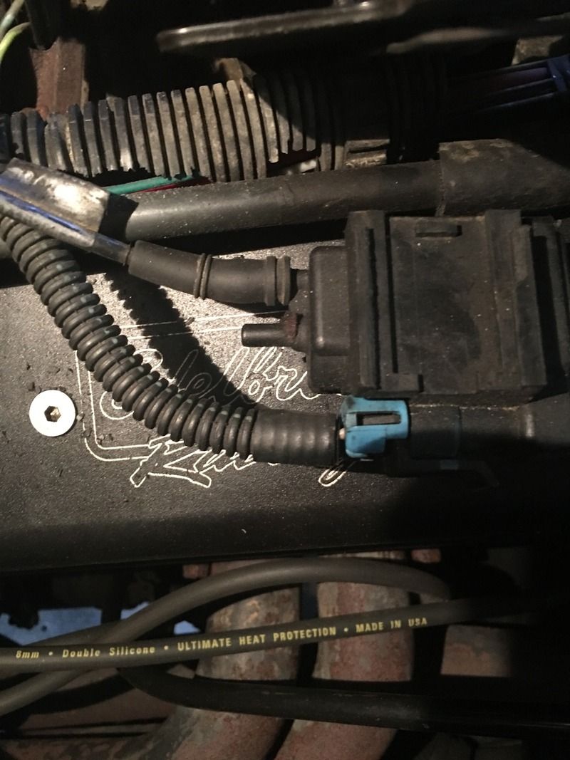

[IMG][/IMG]
should there be something on the end of this?

No. You can test vacuum with a hose and your mouth. Remember there are a few components in the system, not just an egr valve. One thing I would do is clean the valve and the orifice put the valve back on and disconnect it to see how it runs without a functioning egr. Be sure to plug any vacuum lines that are disconnected.

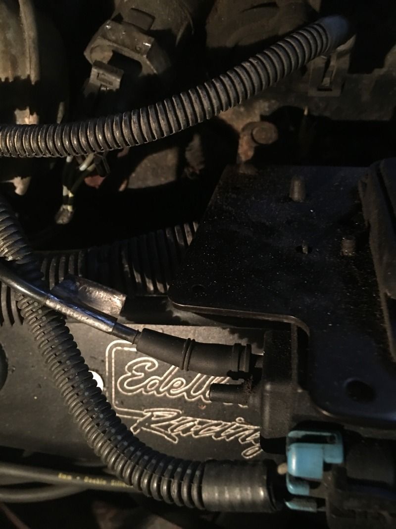

[IMG][/IMG]

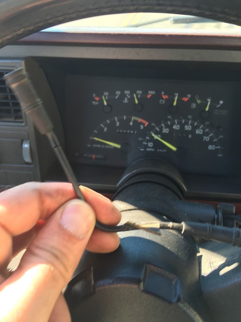

well after swapping out wheels, rallys now on, don't like the look or the tire size, anyway, for 90,bucks guess i can't complain. anyway, after swap i popped the hood that don't want to pop open anymore...and noticed,
[IMG][/IMG]
was not connected to the valve... now, the light was coming on and off before i took off valve to check if it still had play.
so, today i open hood and its not connected. i connect it and push a little harder then should and brake the line.
took if off so i could show auto zone guy what i need. and truck seemed to run fine. held a good idle at every stop or light.
funny how it seems to run a little better without connection.
did notice that when the truck is on, i cannot move valve. and when its off....i cannot move valve.

so the other end of hose that is not connected to the valve. but the little black box. the other nipple does not need to connect to anything?? previous pic.
jasonroman is offline   Reply With Quote
There should be nothing on the other port of the EGR solenoid.
It is the vent port.
From the factory it had a little foam filter on the vent port.
