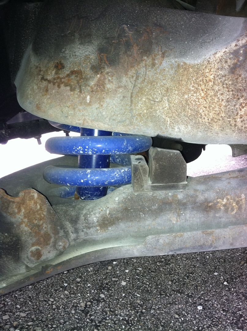

After installing 2" drop springs on the front and cutting the bump stops in half, the front end is still bouncing. I have about a 1/2-3/4" gap at the bump stop. If I make the gap larger, the tires will hit the fenders. I went with a shorter shock, but that may be my issue.
Any ideas? Thanks!

Taller springs, shorter tires, same stance and more suspension travel. From what you are describing you have less than 1" suspension travel and that is nothing! You have to be bottoming out on the bump stops constantly!

I have a shorter tire than stock. I can make the bump stops smaller, but I run the risk of the tires hitting the wheel wells.
Would a stiffer shock help this?

Here is a current picture of the bump stops.
These are the shorter shocks I installed. They are Monroe Matics.
Springs installed with the tire off the ground.

I trimmed off about 3/8" of the bump stops and took it for a ride.. It make a noticeable difference. I have removed a total of 5/8" of the bump stops.
I still think I need a better quality of drop shocks. When the budget permits, I will look into them.

I looked at mine and I forgot that the bump stops are back toward the inside of the A-arms, being back where they are, even with a 1" gap there is more than 1" of suspension travel.
Even so, it is obvious you are still bottoming out on the stops. A shorter or softer bump stop might help the ride BUT it should only hit the bump stops on REALLY HARD bumps. Like a big hole in the road. If you are hitting the stops now, when you hit something hard you are going to rattle the whole truck and that will get old fast! Not to mention it can't be good for the vehicle.
This is why I like drop spindles over springs. You don't loose suspension travel with spindles. Mine came with 2" drop spindles and 2" drop springs with the stock size tires. I didn't like the tires scrubbing on hard bumps and occasional bottoming out. (rode fine otherwise) So I add a 1" lift on the springs, swapped out the front tires for some 2" smaller in diameter and I kept the same stance. I gained tire clearance and added 1" of suspension travel. Now the only time it bottoms out is those really bad pot holes are something similar.

I agree with the spindles, but springs fit my budget better. I will work on a different shock package to see if that helps. The Nitro Drop shocks were some I was looking at.

I did a little more trimming on my bump stops again today.. Now its level with the smaller side of the stop.
