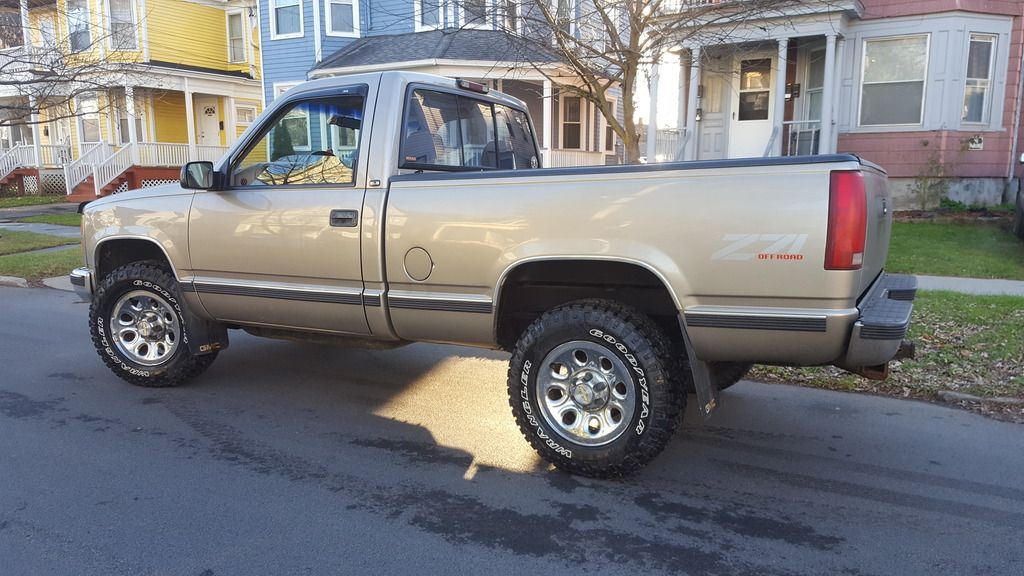

POLL, which engine and trans to use in this 4x4
This is my daily driver, 05 GMC 1500 and I just got a new project truck a 1990 GMC 1500 also black.
Before:
With 6.5" BDS lift and 35" tall 12" wide BFG AT:
This 1990 gmc came with independent suspension but for real off road abuse you want some solid axles... Tons of work went into this and it's really well done.
Pulled it up onto the flat deck for safe keeping, love that PTO winch:
I got the truck as a roller, no engine or trans but I have these 2 trucks to choose from for donors. the 01 GMC 2500 or the 1988 Chevy with 5 speed manual and TBI 350. Obviously the TBI would be an easier swap but the 6.0 would be much better.
Which would you do? The easy TBI swap or the 6.0 swap?

how is the steering hooked up on that? i'd go with TBI, already there, already have all the pieces, have it done in a day...

Thanks for the input, it sure would be an easy swap! All the TBI wiring and computer is in the truck... Then no computer controlled trans and you could row through the gears... It would make it unique to be a manual shifted truck. Here are pics of the steering:

Before you drive that truck, you need to fix the steering. That is NOT the way it's supposed to be. You need crossover steering on these trucks, no way around it.

Thanks for noticing that I will look into options for fixing the steering. I have no idea what kit the Solid axle swap is I got the truck like this for $500. Well worth the $ to me.

http://offroaddesign.com/catalog/Dana44crossover.htm

ORD has some good stuff.....check pass side knuckle to see if it's the right one, if not need to get a flat top....shouldn't be too hard to find, then mill/drill/tap and get studs n steering arm.....
