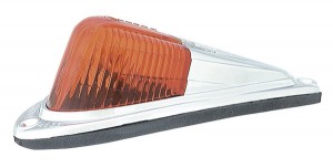

Always thought of these as dealer options that a buyer could order. The 66 data book lists them as "Custom Features (Dealer Installed)". But this picture seems to make one wonder... If they're on a smattering of assembly line trucks, then that doesn't seem like a dealer add-on, now does it? Thoughts? I know there were no factory guide lights like the 67-72 era (with roof pads), but always thought they yankee style were dealer only. This style is kinda growin on me....

They would have been put on (some off the line and some built to order trucks but YES you could get factory installed ICC lights) C-80s and the like as where required by ICC and they were on 67/72s also on the bigger trucks https://en.wikipedia.org/wiki/Chevro...Roxbury_NY.jpg
Also on smaller 67/72 trucks from the factory as seen in this pic look at the raised area in the sheet metal for the roof lights https://upload.wikimedia.org/wikiped...e_%2711%29.jpg ... Back in the 50s they only had 3 lights on the roof

if you could order them in 60-66, what was the RPO? Aware of the raised pads in the 67-72s, but U01 didn't come around til 67-72 era either as far as I'm aware.

The light configuration was symbolic of the width of the truck. Two at the extremeties and three Iin the center were to indicate a width up to 102". In the medium duty cabs, it came prewired. Run your arm up the rear pillar on the drivers side and you should feel the coiled wire hanging tthere. Also can be accessed through the hole of the drivers side sunvisor. Look in my Picasa photo album , there should be instructions for installation.

RPO V75 Marker & Hazard Lamps
This style went into the 70's.
Grote replacement
http://www.grote.com/family/deluxe-d...-marker-lights

RPO V75! Thanks aerotruk! Saw the pic in the 66 data book, just couldn't find the code. That's what I was wondering and it explains the picture now.

Dang... didn't know those were still available new! Now I'm thinking about putting them on my '62 K10... I WILL be putting factory spot lights on it--they come in handy for cleaning deer and setting up camp at night. But the cab lights just kinda look cool. AND, they tend to make the vehicles a little more visible at night... or at least more imposing before someone decides to pull out in front of you.

Watch for water infiltration. You will be putting holes in a previously solid panel.
If I do it, the silicone will be spread under that gasket and around the holes like frosting on a birthday cake!
