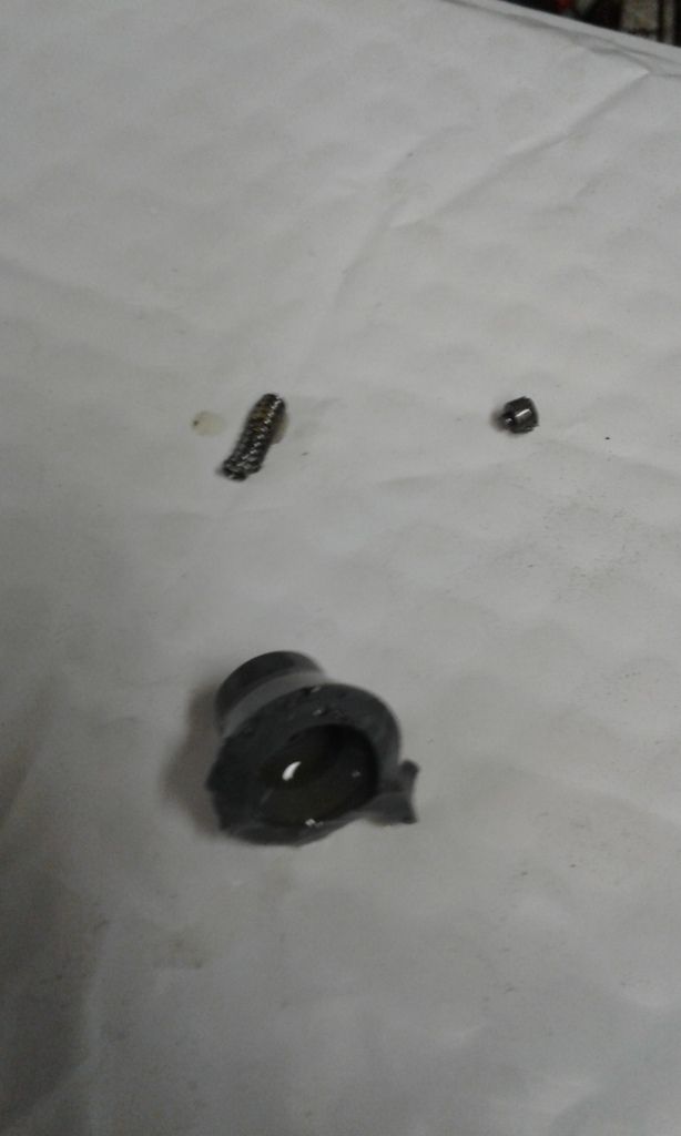

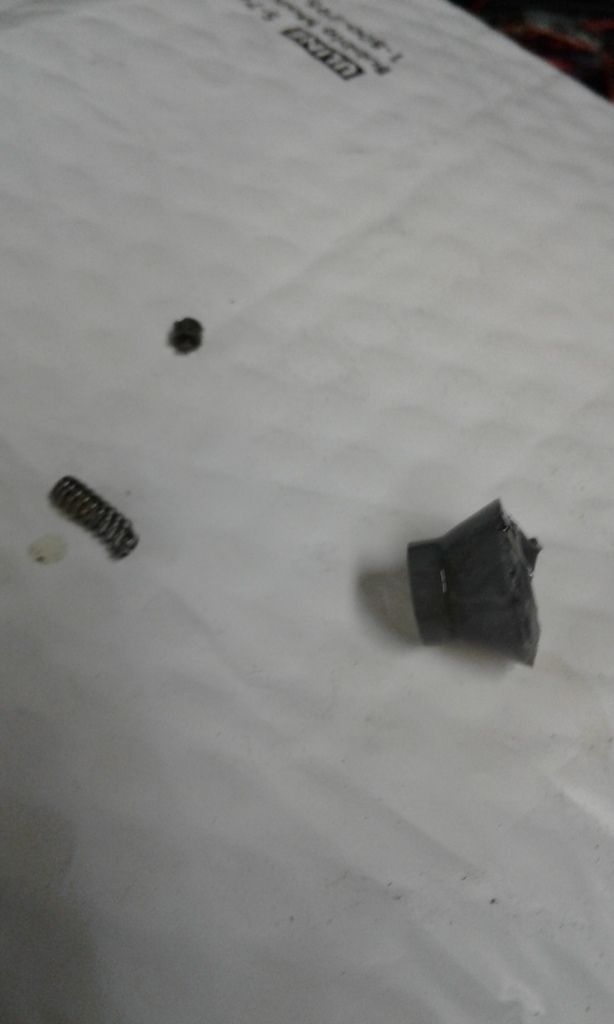

I still have no clue what happened...
These little pieces...

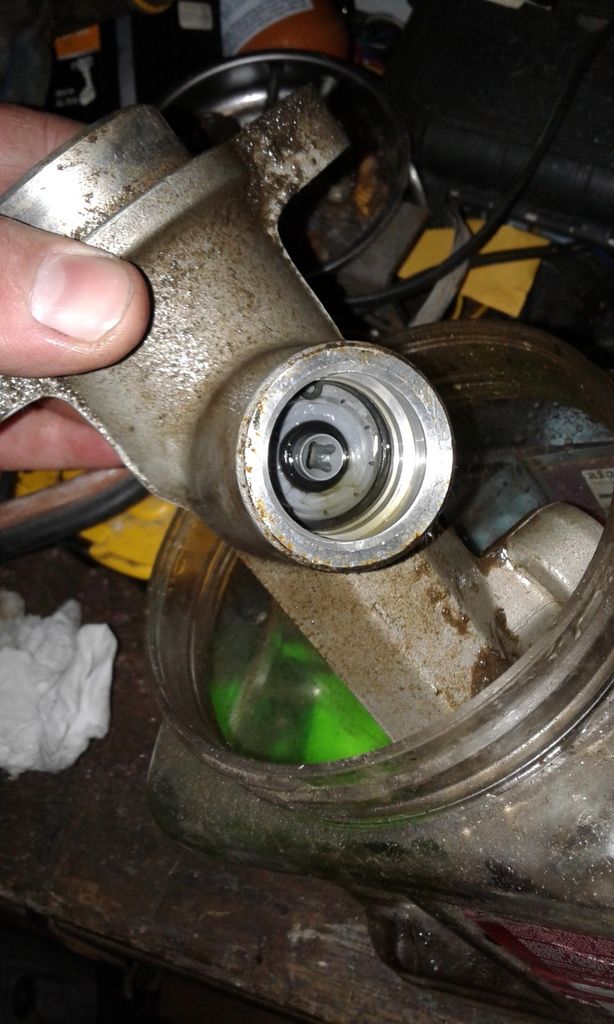

Came out of this....
