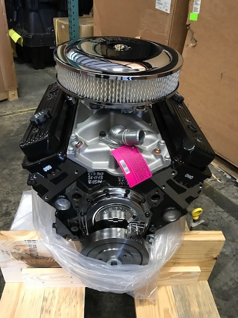

SEMA pic:
Here's what mine will look like when it shows up, before the serpentine install. Now they're shipping them with chrome timing cover and air breather, but black valve covers for some reason.
