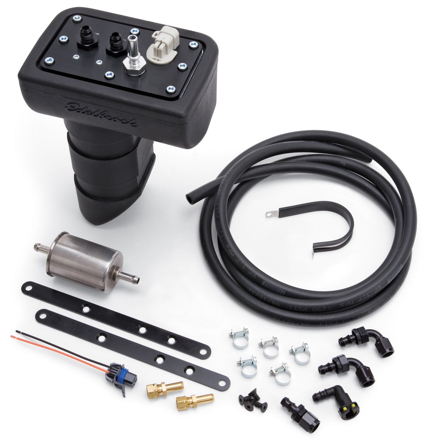

This is the sump that I used Edelbrock 3605. Their brackets would not work so I made my own. Was a tight fit but it works great.
