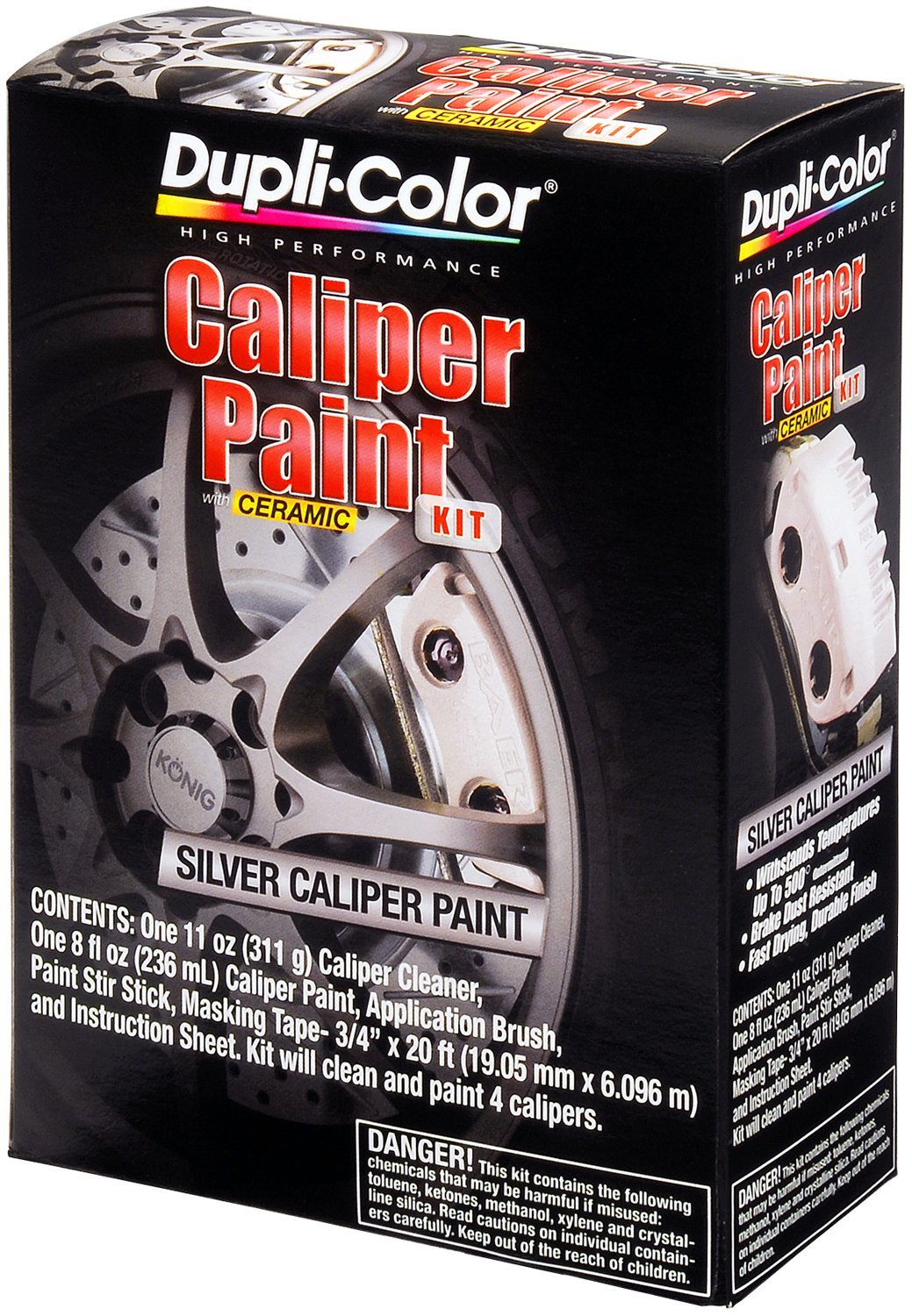

I bought the caliper black paint kit. This is silver but the same kit.
I then just wired brushed it down good with a big brush and a small one. I got it as clean as possible then wiped it down with brake cleanner. Let it dry good and then brushed on the paint.
I didn't take it loose but if you want it want hurt a thing.

This stuff is thick so put it on thin. I did 2-3 coats.
I'm thinking about doing the top in red also.
