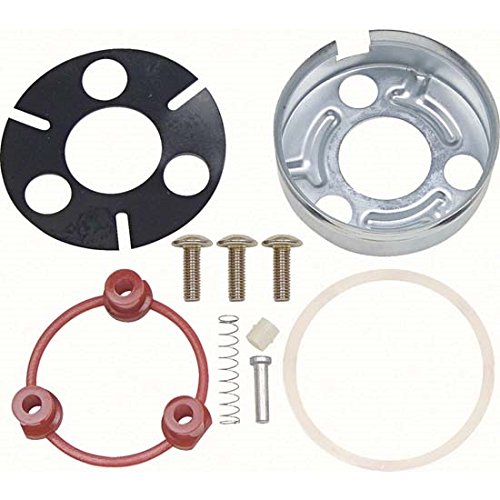

I bought a factory wheel from a parts source of mine upstate, and installed it on the 67 GMC. But the aluminum "cup" that holds the horn button in place is LOOSE and the three screws that secure it will not go in any further. I have the steering wheel, the plastic ring for the screws, the screws, the retention nut washer, and the "cup". Is something missing here?

Here is what you should have and need.

Check this out I believe it has the answers you need. The slotted disc is what gives the horn button its spring action.
