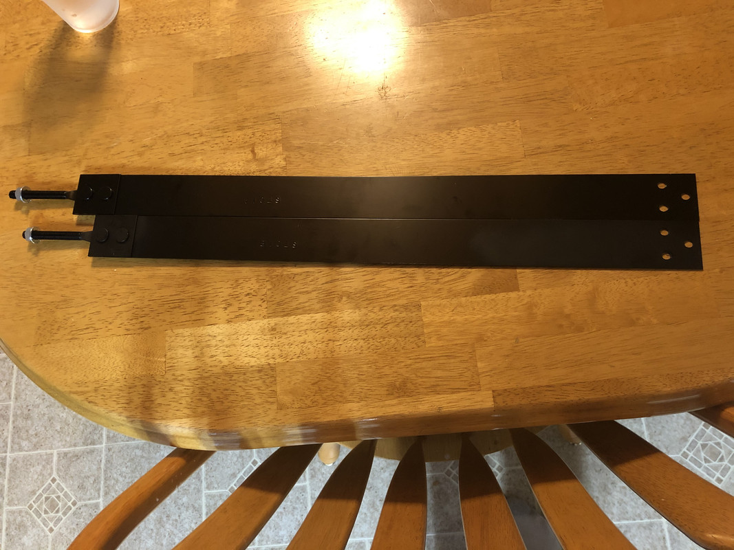

This is probably a stupid question, but I want to double check before I waste my rivets doing it wrong.

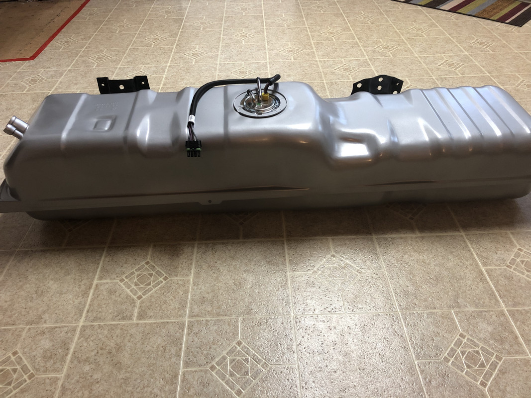

On the fuel tank straps, one strap is longer than the other. Does the longer strap go with the taller bracket (and taller side of the tank), or the other way around?

Thanks, but I’m looking for the actual strap portion itself, as the replacements have two different lengths and mine were so rotten that I didn’t get to measure the old ones. The brackets are self explanatory, they can only fit on one way on each side.

Both of my factory straps measure the same - 24 1/8 inches. The threaded bolts attached to the end of the straps are the same length as well.

That’s weird, they’re supposed to be different lengths

Took a chance and figured it out. Short strap goes on the short hanger (towards the front of the vehicle), and the long strap goes on the longer hanger (rear of vehicle).
